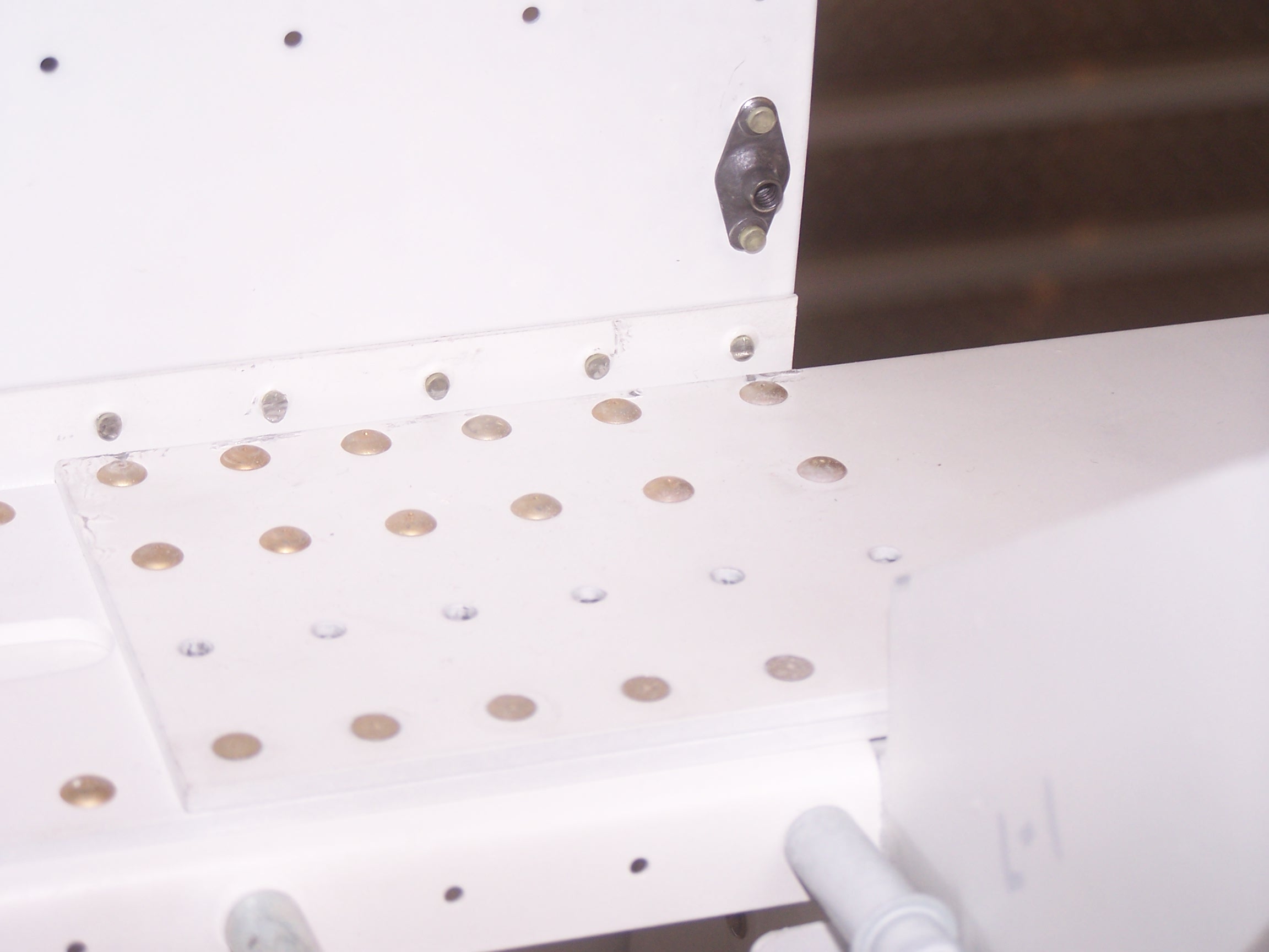

These are on the top wing skin (section 16). Riveting the skin to the rear spar flange on the inboard edge (where the rear spar reinforcement fork and doubler plate are). As you can see, mine turned out less than stellar. I'll drill them out and try again but thought I'd see if anybody has any secrets. There isn't much room between the tail of the rivet and the doubler plate to get a bucking bar on it square and I don't have a squeezer head deep enough to reach over the skin edge.
Thanks in advance
Bill

PostPosted: Wed Feb 24, 2010 10:21 am    Post subject: Re: How did you set these rivets Reply with quote
Bill,
What shape is your bucking bar? There's no problem with resting the bar on the heads of the 470s in order to keep it square. It also might help to use a partner so that the bucker can focus 100% on keeping the bar square to the rivet.
While you're at it you might want to check your pressure as all of those rivets look over-driven. 35-38psi is all you need for a 3-3 to 3-5 rivet. Also try shortening your shooting duration to say just over a second, stop and see how the rivet's setting. Better to under set and hit it again with a quick blurp then to blast away. Don't worry about work hardening these small rivets.

PostPosted: Wed Feb 24, 2010 3:54 pm    Post subject: How did you set these rivets Reply with quote
I guess I didn't get my point across in the original e-mail. The 470's
aren't the problem. The problem is that the tails of the AN426AD3's when
not driven are nearly below the surface of that doubler so they are about
impossible to get at. Compound that with the fact that they ARE NOT
perpendicular to the doubler plate (the flange on that rear spar is at an
angle to the doubler) makes them pretty tough to get at. Laying a bucking
bar flat on the 470's and driving the AD3's in the flange will just lay them
over.
Clear as mud?? I'll try to get a pic to explain.
Bill

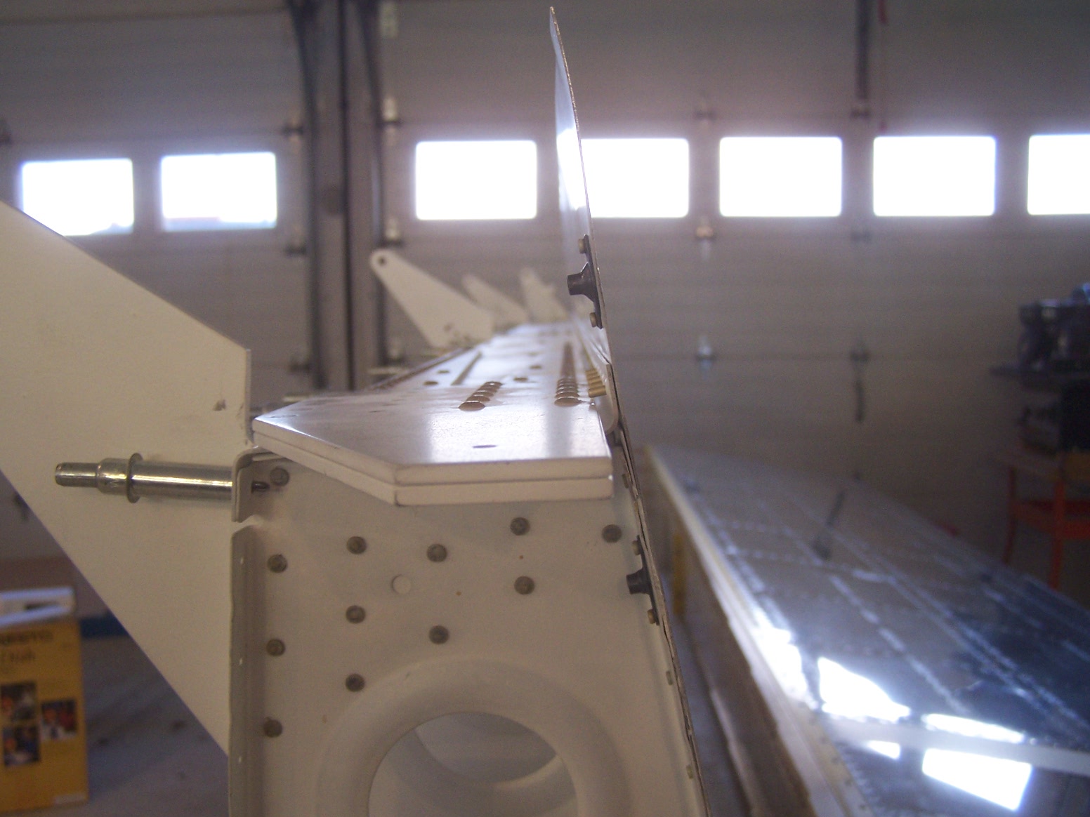

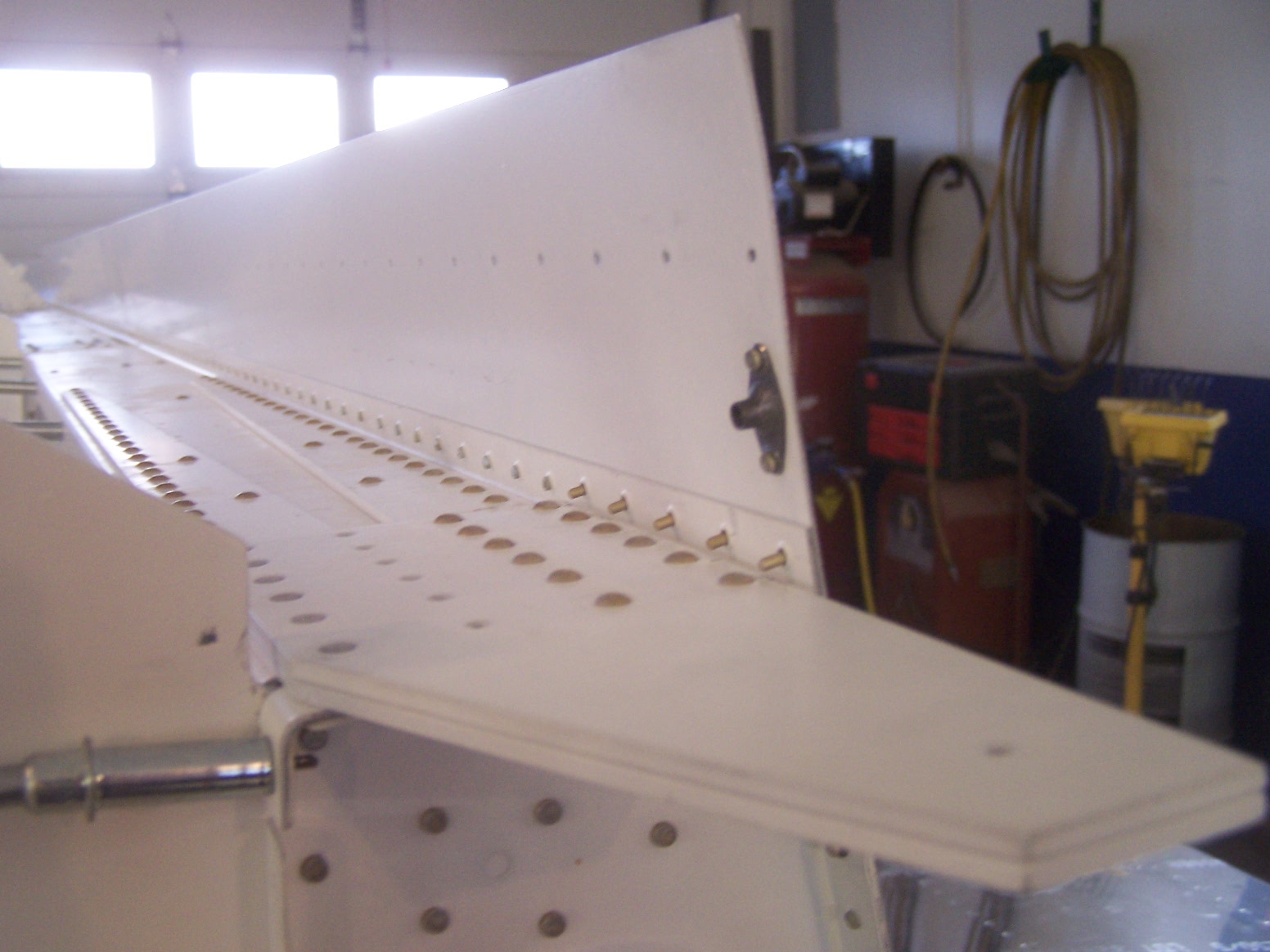

PostPosted: Wed Feb 24, 2010 4:01 pm    Post subject: How did you set these rivets Reply with quote
The 470's weren't the problem. Problem is very little room to get to the
tails to buck the AD3's. Setting the bucking bar directly on the 470's
isn't the best way either because there is actually some angle to the AD3's.
See the attached pictures for a better description.
BTW: Sorry for the huge pictures I sent earlier. Reset the megs on my
camera to it's lowest setting. Maybe these won't take up as much space.
Bill

pitts_pilot(at)bellsouth.
PostPosted: Wed Feb 24, 2010 4:45 pm    Post subject: How did you set these rivets Reply with quote
I have a bucking bar just made for your application .... picture a soap
bar with a 'ledge' protruding from one of teh short edges.
Linn

jcumins(at)jcis.net
PostPosted: Wed Feb 24, 2010 5:15 pm    Post subject: How did you set these rivets Reply with quote
They make a bar that will fit in their real nice. My tungsten bad has a end that has a edge with a lip that will allow the bar to be canted at the angle of the spar and skin what will fit between the rivet and the existing 470 rivet.
This bar makes riveting so simple just don’t drop it or it will ding your skins in a heartbeat. I am getting in the practice to lay carpet down on all material being bucked so if I do drop it no damage is done.

jeff(at)westcottpress.com
PostPosted: Wed Feb 24, 2010 6:04 pm    Post subject: How did you set these rivets Reply with quote
You should be able to "free hand" an angled face bucking bar in that
spot without much of a problem. Use your thumb and forefinger to
square up the face to the surface... and tape off the bar where it
might bounce in to something you don't want to scratch.
Can't you use a bucking bar with an angled face? Then you don't touch
the 470's and can adjust for the angle difference...

PostPosted: Wed Feb 24, 2010 6:14 pm    Post subject: How did you set these rivets Reply with quote
That looks exactly like what I need. Looks like I need to expand my bucking bar selection.
Thanks guys.
