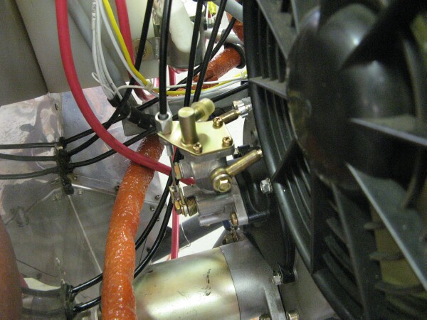

I finished the retro fit of an oil injection for my Kitfox a while back and finally we have good weather to test it out. Yesterday I went up and burned three gallons of gas mixed 100:1 to make sure it was working. Today burned my first tank of straight gas. It appears to be using about 60 or 70:1. maybe it's just me but the little 503 seems to run smoother with the injection. I'm happy not to be premixing fuel any more!

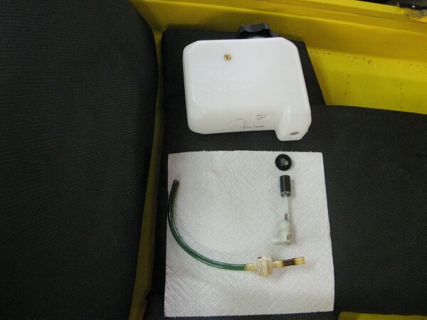

FWIW, the oil injection system parts are very expensive. About $800 if you buy all new stuff. The pump is $285 new. I found a pump taken off a new engine for half price from a guy that didn't trust oil injection. The tank with low oil warning capability, cap, lines, and filter are off a 99 Ski Doo Skandic from ebay for $20. New from rotax is about $200. The manifolds are "recycled" from CPS for half price.
After I started collecting parts it became evident there are quite a few Rotax oil injection parts sitting on shelves owned by people that don't trust the system or for some reason think it is too heavy and robs power.
