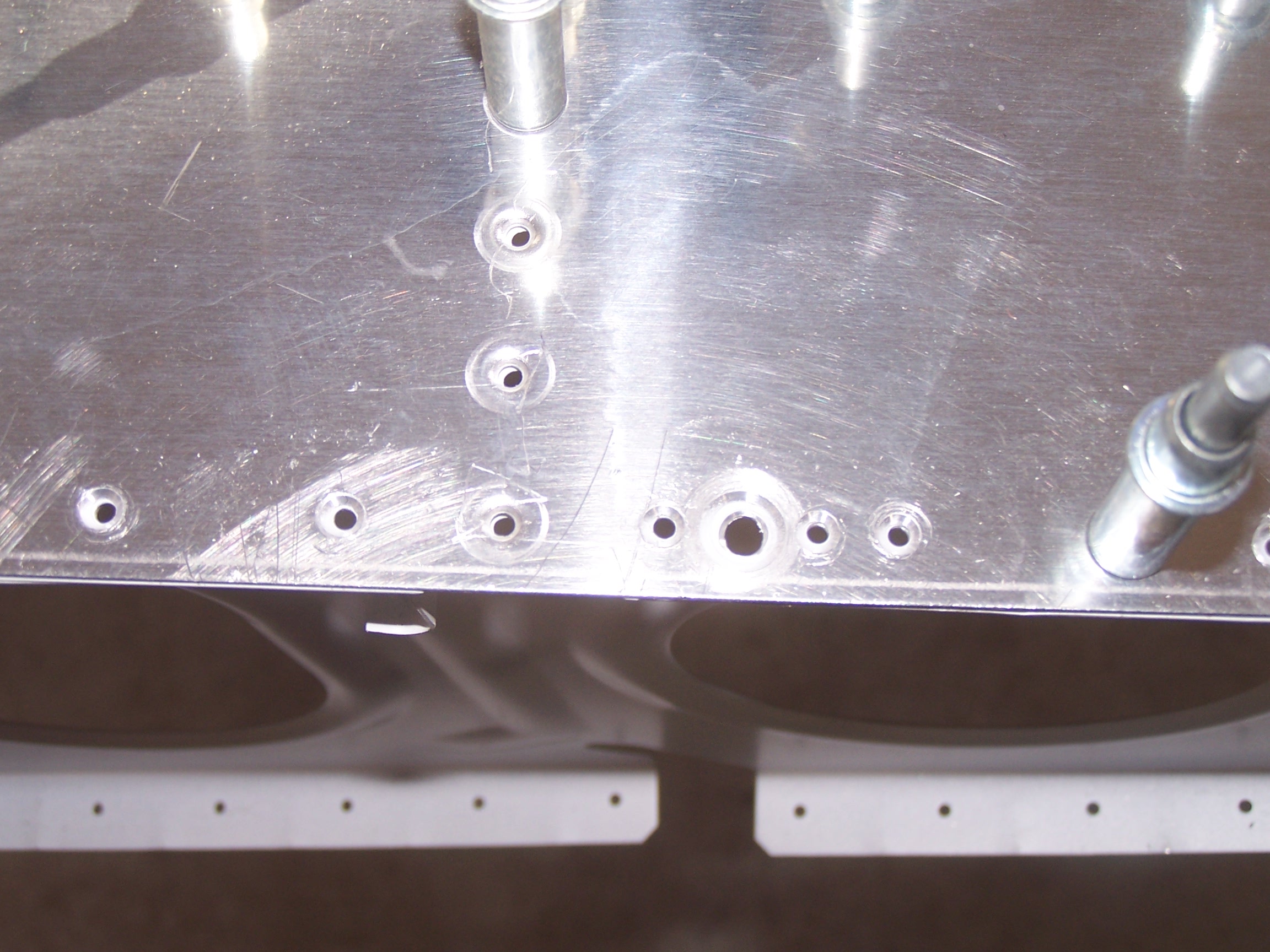

As I was getting ready to start riveting on my top wing skins today I found a mistake I made when drilling out my top inboard wing skin nutplate holes on the inboard side. On page 16-2 step 3 we are to drill out to #19 screw holes on the inboard edge of the W-1002 inboard wing skin. I somehow missed one of the holes by one. It is the hole directly below (aft) of the center rivet line on the skin ( rivet line where the W-1028 wing box J-stiffeners are riveted to). The enlarged hole is supposed to be the hole directly aft of that center rivet line. As you can see from the picture I messed up and drilled the second hole aft and countersunk it for a #8 screw dimple.
Are these nutplates for the wing root fairings? If so,can I use a K-1000-08 nutplate here also and modify the wing root fairing? If not are there any other suggestions? Looks to me like If I start over I'll probably have to buy new skins (made the same mistake on both wings), and ribs (since the #8 dimple countersink went into the rib).
Any thoughts or suggestions? I'll try Vans tomorrow but they are closed today for Presidents day.
