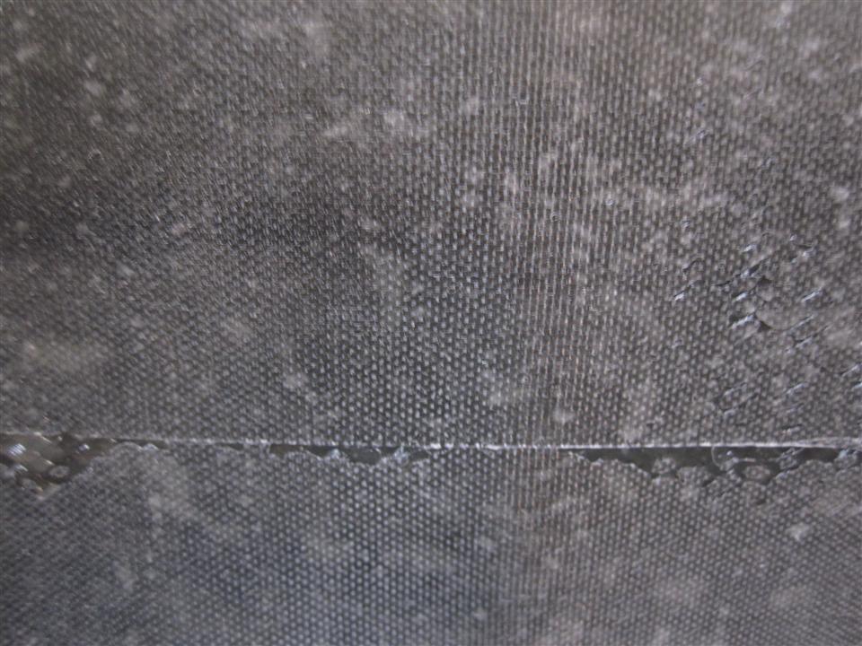

Clearly I still have no idea what I'm doing with fiberglass.  In the attached picture you can see numerous bubbles in the layup of our windshield fairing. Is this anything to be concerned about?

>From the picture it is very difficult to tell what it is that we are supposed to be seeing.
Maybe these are bubbles, maybe it is unsaturated fiberglass(resin deprived)
Either way, the cure is the same. More elbow grease while working the resin into the glass fibers. You should be using a disposible paint brush and angling it at say a 60 degree angle to the layup and smashing the glass so the resin works its way into the glass. You will hear popping noises, these are all the airbubbles being worked out of the layup. If done correctly, the hand and wrist gets quite a workout and the bristles on the brush get really beat up by the end of the job. You will learn how to use this meathod to get the glass to creep where you want it to.
As I have said before, never use the same brush with different epoxy batches, it will let the new batch fire off way sooner than it would have with a new brush.

What epoxy are you using? I would recommend the MGS 335 epoxy with the slow hardener if you are new to epoxy. It is virtually odorless and is easy to work with and has excellent wet out properties along with superior structural integrity. The photo is hard to judge, but the rule of thumb for building a Rutan composite building for defects is nothing more than 10% of the area. That's a lot of defect leeway and one would have to be really sloppy to have that much! Use a 1" natural hair bristle paint brush (the cheap ones from Harbor Freight are perfect) and "stipple" the epoxy into the cloth. Use a hair dryer for heat while you do this. It makes wetting the glass out a lot easier. Use a hand held light and inspect your work for air bubbles and cloth that is not wet out,,,,,defects will really stand out with light. You can go to the EAA web site under builder tips for instructional videos. YouTube also has a lot. Good luck.

One more thing. Sometimes no matter how hard you try,,,you can't get some air pockets out by stippling, Use a tooth pick or better yet a metal pick to poke the glass to make a separation in the fibers to allow the air to stipple out.

I used one of those plastic rollers made for fiberglassing. It really helps to lay down the glass saturating it to eliminate bubbles

Thanks, guys... I'm using West System w/ the fast hardener (it's pretty cold here).  The glass was definitely wet enough; as was suggested, I think the problem is that I wasn't aggressive enough pushing the resin and getting the bubbles out from between layers.  If this was a critical structural piece, I might think about whether it's satisfactory, but I'm thinking I'm fine here.  Will call Van's in the morning to verify.
Interestingly, I'm working on my spinner tonight, and it has quite a few bubbles as well.

I don't think so. You need to cut a cheap brush down so it's stiff.
Use it and some resin to poke where the bubbles are and the bubbles will
work their way out. Well, it won't work well on the hardened fairing
very well, if at all ..... but it will on subsequent layers.

PROBLEM YOU MIGHT BE HAVING IS IF YOU ARE LETTING LAY UPS CURE. LAY-UP OVER THIS THIS CURED EPOXY HAS A AMINE BLUSH AFTER CURING THIS AMINE BLUSH IS REMOVED WITH WATER ONLY THEN SANDED THIS WILL MAKE A SECONDARY BOND BETTER. I USED WEST SYSTEM ALSO HAD EXCELENT RESULTS WITH WINDSHIELD FAIRING. ALSO GET FRON YOUR EXPOXY DEALER THE MANUAL FOR WEST SYSTEM. (ITS FREE)

You mentioned that it was cold there. Many resins get more viscous at lower temperatures, making it more difficult to wet out the cloth. Make sure you are working at the recommended temperature for your resin and work out the bubbles with a stippling action of the brush.

Don MacDonald gave me some advice a few months back.. use a work light. the
500w one sold at HF put out a fair amount of heat. I just completed my
plenum using the light and everything cured well, and more quickly.. In a
cold environment just set the lamp a few feet away from the work area and it
will produce the added heat. I set a thermometer over the work area to keep
the glass at 80-85 degrees.

Be really careful with a heat lamp or work light near the plexiglass.  Ask me how I know!  For sure use the thermometer you talked about, but keep in mind the temp will climb if it's not regulated.  We've been using some electric blankets for temp control lately that work really well.  If you pushed one down inside the base of the windshield that should keep the aluminum and the plex warm but not too hot.
I agree with the other comments regarding the bubbles.  Small specks like that aren't going to have much effect one the layup.  A little more resin/working time/warmth might have helped but from the picture I saw I wouldn't redo it.

If your working in cooler environments, keep your resin warm before you mix it. I find this helps alot.
