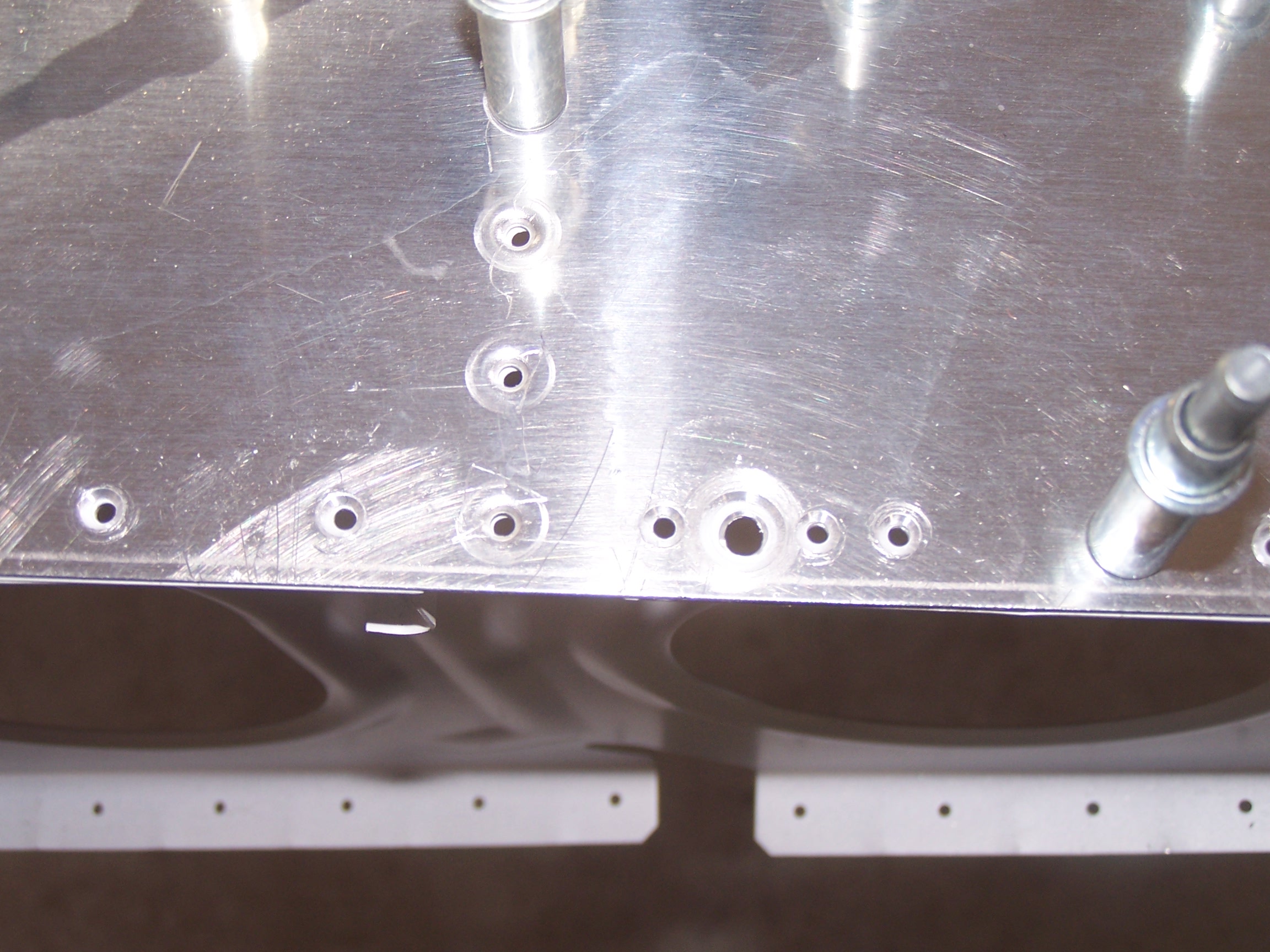

As I was getting ready to start riveting on my top wing skins today I found a mistake I made when drilling out my top inboard wing skin nutplate holes on the inboard side. On page 16-2 step 3 we are to drill out to #19 screw holes on the inboard edge of the W-1002 inboard wing skin. I somehow missed one of the holes by one. It is the hole directly below (aft) of the center rivet line on the skin ( rivet line where the W-1028 wing box J-stiffeners are riveted to). The enlarged hole is supposed to be the hole directly aft of that center rivet line. As you can see from the picture I messed up and drilled the second hole aft and countersunk it for a #8 screw dimple.
Are these nutplates for the wing root fairings? If so,can I use a K-1000-08 nutplate here also and modify the wing root fairing? If not are there any other suggestions? Looks to me like If I start over I'll probably have to buy new skins (made the same mistake on both wings), and ribs (since the #8 dimple countersink went into the rib).
Any thoughts or suggestions? I'll try Vans tomorrow but they are closed today for Presidents day.

Well, if it were me, I'd put an AN426-5 or -6 (depending on the exact hole size) rivet into these "mistakes", call it a "feature", and move on.

This is a common mistake, mentioned by many. You can slightly countersink the back side of your mistake, then squeeze an AN426AD5-3 or 3.5 in there to fill the hole. Then just drill through center of rivet for correct hole size, file shop head to almost flush and you are good to go. A bit less kosher method would be to fill the hole with JB weld epoxy. Or you can do as you propose drilling a new hole in the fairing. The rivet the hole shut method will be the least detectable, most durable.

Put one in the other wing too.. Then if anyone asks you about the
larger rivet, you can just look at them with a straight face and say,
"Didn't you get the service bulletin? You need to go read it."

Does anybody have maybe 4 or 5 each of AN426AD5's and AD6's you could send me (I will pay for them)? I will order some from Vans but sometimes their shipping is kinda slow and I'm at the point that I need the rivets NOW. If so you can e-mail me off list at william(at)gbta.net.
Anyway, thanks for the help. Better pay a little more attention from now on.

If this rivet hole is in the wingwalk wing-root fairing area,
I did the same thing....it was supposed to be a single-ear
nutplate instead of double, or something like that. Drilling
it wrong isn't good, because the fairing is already pre-drilled,
so then you'd have 2 holes next to eachother. The way I fixed
it was fill the mis-drilled hole with JB weld for cosmetic
purposes and then re-drill and countersink the proper hole.
If the wing root fairing wasn't pre-drilled, I would have just
left it, but since the fairing is, you should just fix the hole.
I doubt there's a strength issue to having 2 holes drilled
and countersunk...but you just want the nutplate to hold.
After filling with JB weld I think I still riveted it properly.
Bill

This is exactly what I'm talking about. The plans call for a single ear
nutplate instead of a double. When I was drilling them out I automatically
drilled the center of the three holes on all the locations. Well, in this
one location the forward hole was to be drilled out--not the center.
Naturally it is countersunk for a #8 screw DIMPLE so it's a rather large
hole there in the wrong place. My initial intentions were to just use a
regular K-1000-08 nutplate and forget about it until talking to Scott at
Vans. He informed me that the wing root fairings come pre-punched so the
hole really needed to be moved to the correct location.
Anyhow, sounds like JB weld should be a rather quick and easy fix.

Talked to Vans about it and his suggestion was to use this route (the enlarged rivet mentioned below). It looks like if I move the hole to the correct location that the new countersink is going to overlap the incorrect countersink in the skin. I'm afraid this might leave a fairly large "loose" section on the skin. I'd like to hear from others who have made this mistake and see how it worked out for you.
Also, I need a source for AN426AD5 and AD6 rivets.

Any airline mechanic or shop that works on twins and up. I found AD5
fit perfectly. Formed up nicely with my squeezer set for bare minimum
shop head remaining. It does hold the skins together until you get
around to doing the nutplate. IIRC, I don't think I did the
countersink in new location until after riveting the nutplate in
place.

From: Kelly McMullen
Sent: Monday, February 15, 2010 11:10 PM
Subject: Re: Drilled hole in wrong place
Kelly McMullen
A&P/IA, EAA Tech Counselor
KCHD

Interestingly, this is one of the "gotchas" I have listed on my site:
http://www.myrv10.com/tips/gotchas.html
Included is even a picture of the offending location. I put it there
in 2005 or maybe it was 2004. Smile
Tim Olson - RV-10 N104CD
automatically drilled the center of the three holes on all the
locations. Well, in this one location the forward hole was to be
drilled out--not the center. Naturally it is countersunk for a #8 screw
DIMPLE so it's a rather large hole there in the wrong place. My initial
intentions were to just use a regular K-1000-08 nutplate and forget
about it until talking to Scott at Vans. He informed me that the wing
root fairings come pre-punched so the hole really needed to be moved to
To those of you who offered to send me rivets---Thanks a million but
looks like for now I won't be needing them.
Tim, if you read this I might drop you an e-mail for some specific
details if you can remember that far back.
Bill
From: "Tim Olson" <Tim(at)myrv10.com>
Sent: Tuesday, February 16, 2010 1:25 PM
>> rib). Any thoughts or suggestions? I'll try Vans tomorrow but they
>> Thanks,
>> Bill
Bill

Thanks Tim. I'll definitely be checking out your "gotchas" a little closer
now. Thanks for the e-mail also. Now that the excitement and worry about
my latest mistake is gone I can get back to building. I do have to say
that it makes me feel a little better that "the man" made the same mistake I
did. LOL!!!!! Just kidding Tim!!
