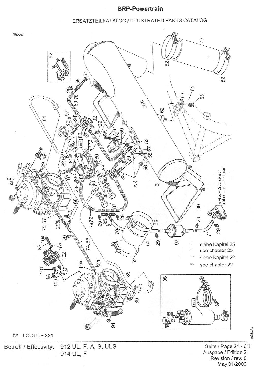

Ivor, where is this blanking plug on the 914 inlet?

PostPosted: Fri Feb 12, 2010 10:32 am    Post subject: Location for temperature sender/s Reply with quote
Hi Kevin
its number 56 on the attached JPG
Ivor
