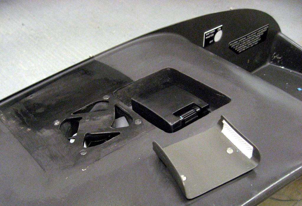

PostPosted: Tue Feb 09, 2010 3:04 am    Post subject: Instrument module cooling/demisting Reply with quote
The attached is a view of the top of my panel.
The fan works well as a demister and removes any excess heat from the panel
The GPS aerial gets a very slightly better signal as it is not under the
panel
The mount on top is for the PCAS unit we have.
I hope this might give you some ideas. BTW I have repainted it since this
picture was taken.
Ian Rickard G-IANI XS Trigear, 280 hours
