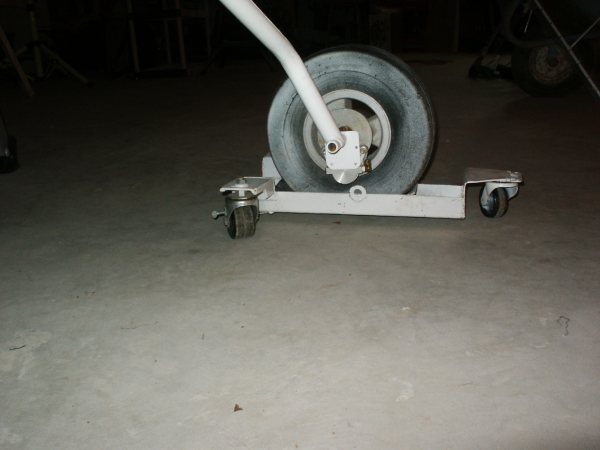

  The one photo is of my front wheel dollies.  The steel one in this photo is my second version.  These work great!!!   The previous first set of wooden ones stunk...they easily flipped over with the slighest obstruction.
  The second photo is of my tailboom dolley.  As I've stated before C I copied Uncle Craig's (of the Kolb list) design and modified it to fit my needs.  I got the pneumatic tire castors from Harbor Freight for about $12 each.  This tailboom dolley is for the "outdoor" crowd.  It is sturdy and tall enough for mild outdoor travel C like being towed to my local airport.
