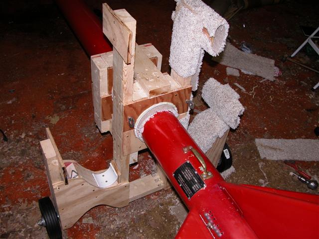

NeilsenRM(at)comcast.net
PostPosted: Sun Feb 07, 2010 11:55 am    Post subject: Tailboom Dolly Reply with quote
Pete
Attached is a photo of a wood dolly that I built (under construction) specifically for holding the tail and wings in my trailer. You could make a wider base with caster wheels and not clamp the fuselage tube as I did for trailer use.
Rick Neilsen
Redrive VW Powered MKIIIC

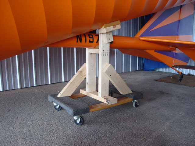

PostPosted: Mon Feb 08, 2010 5:50 am    Post subject: Re: Tailboom Dolly Reply with quote
When I was flying an early firestar and folding the wings for each flight, I built a wooden dolly that also supported the wings up high over the tail wires so I wouldn't have to fold the tail for each flight. It saved enough time to make it worthwhile. Photo attached.
The photo doesn't show this but I held the wings in place with a hose that fitted over the aileron balance tubes on one end and bungeed the other end together with a wrap of foam rubber around the boom where the wings made contact.
