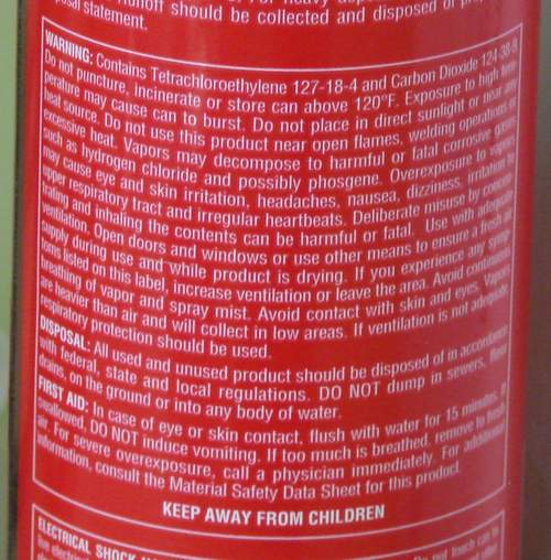

This warning has been going around on other technical forums for a couple of months. Just an FYI.
