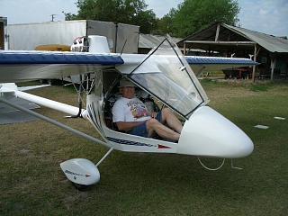

zeprep251(at)aol.com
PostPosted: Wed Feb 03, 2010 4:56 pm    Post subject: rum rum Reply with quote
Boyd,
Tried that too.I think it helped some.Can maybe see the exhaust in this photo.
G.Aman
 Filesize:  17.43 KB
 Viewed:  3393 Time(s)
PostPosted: Wed Feb 03, 2010 5:22 pm    Post subject: rum rum Reply with quote
Gary/Gang:
Got a bigger photo?
john hauck
titus, alabama
