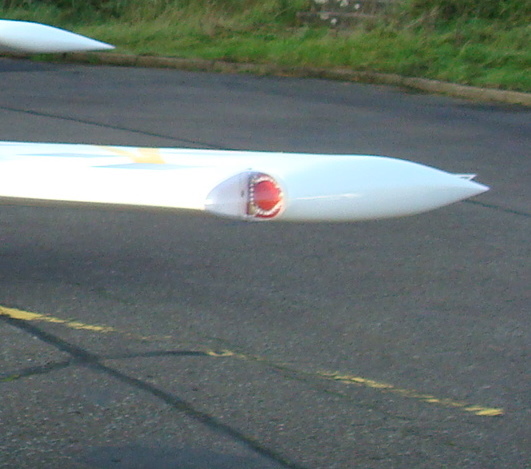

Hi John,
I did the same as Bruno, but did not install landing lights. As you know "they" won't let us fly at night this side of the pond Sad . Also I fixed the strobes on the fuselage separately. Not sure if Fred Klein still makes the covers.
Cheers Danny G-ceri
