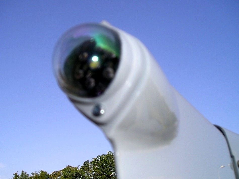

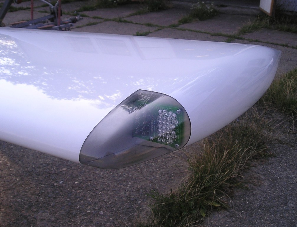

I have used the LED system from CreativeAir.com.
They offer LED’s only and also combos with landing light.
They are integrated in the wing tips. The covers for this I have got from Fred Klein.
It is a very clean solution.
As tail light (when LED’s, than all over) I have installed the very bright LED from PerihelionDesign.com
See pictures.
Best Regards,
Bruno
