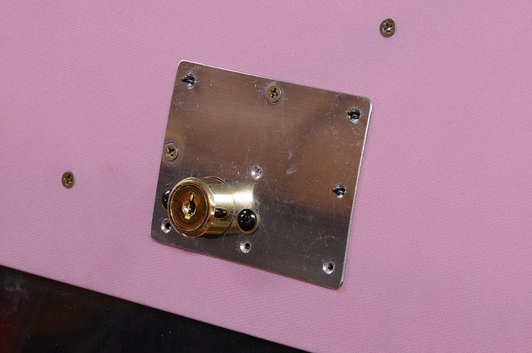

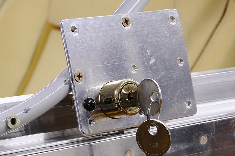

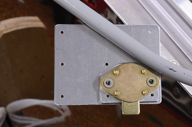

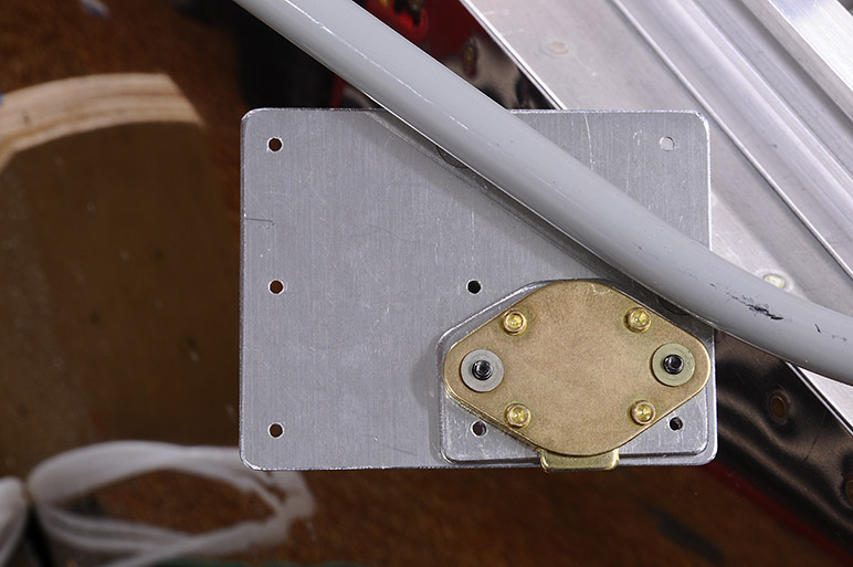

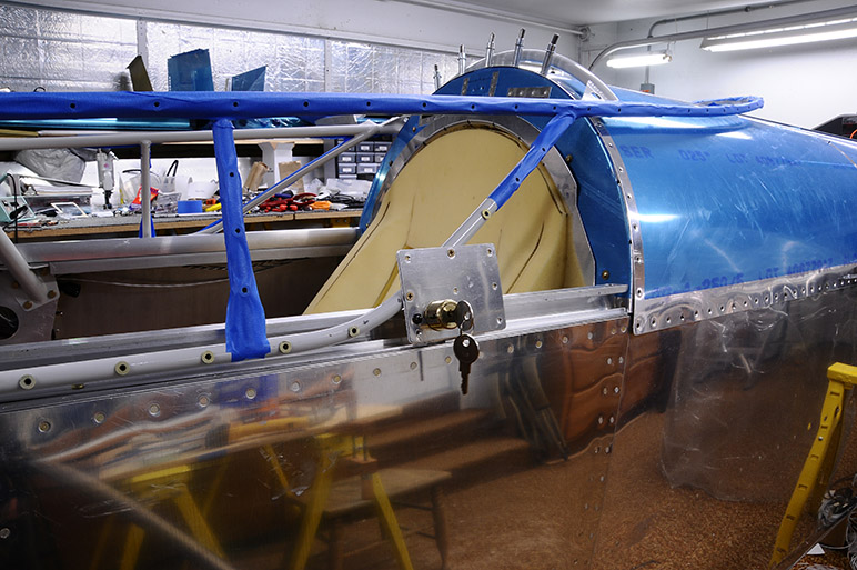

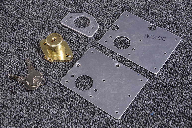

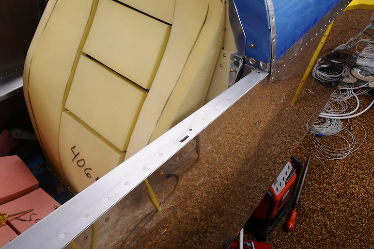

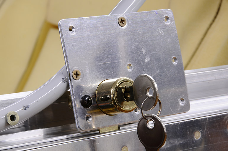

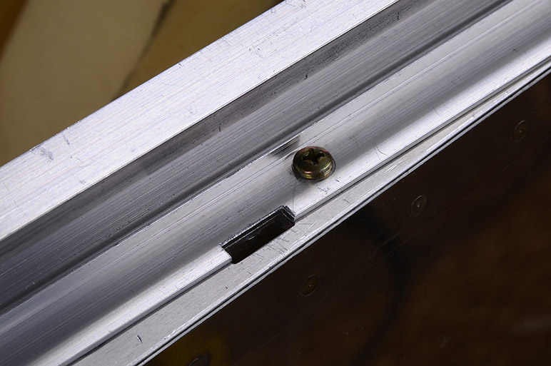

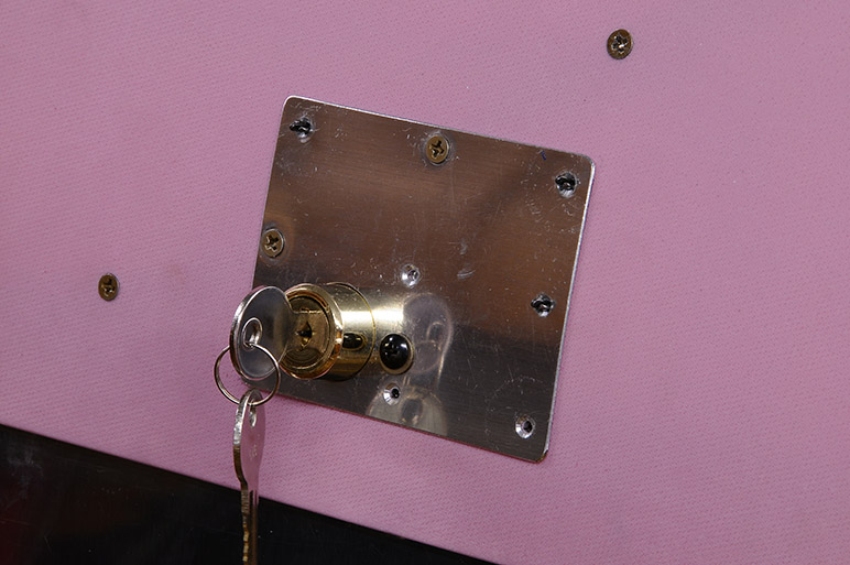

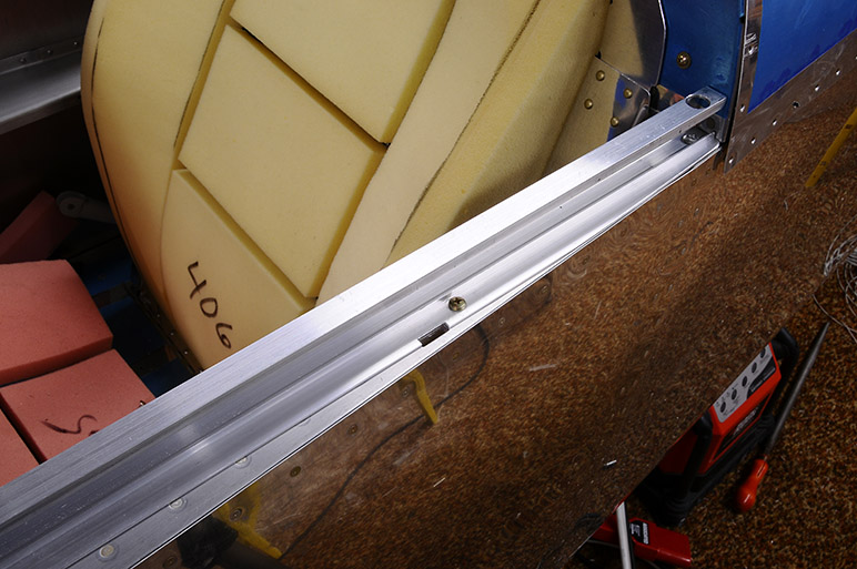

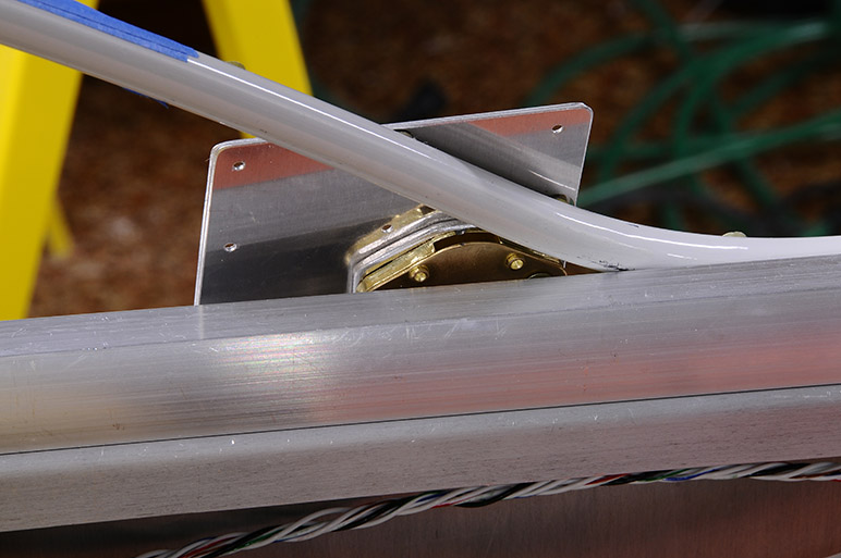

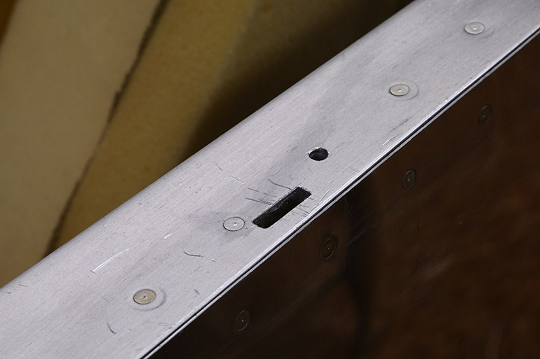

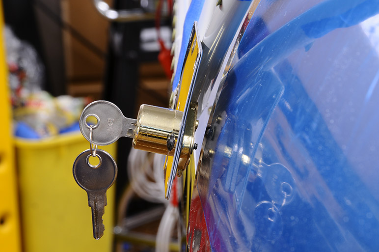

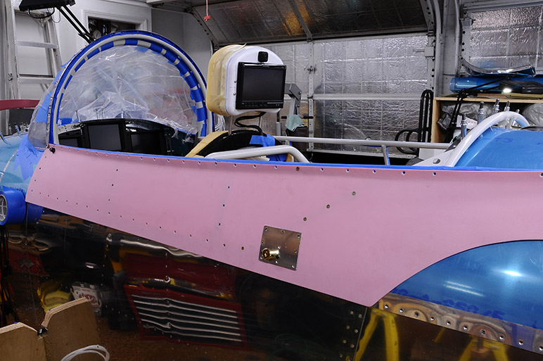

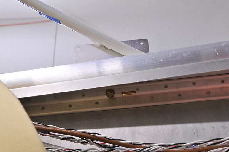

I might have posted these before, but here are a few pictures of the canopy lock installation I came up with for the RV-8. Works really well. The extended barrel also makes a really nice handle for opening the canopy.
