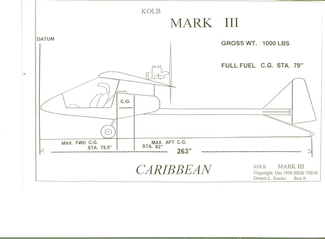

slyck(at)frontiernet.net
PostPosted: Mon Feb 01, 2010 5:08 pm    Post subject: 912 Reply with quote
<Ted,
As a fellow Slingshot driver, I appreciate the fine qualities of our airplanes and wish I could add something to help with your non-Caribbean Rum Rum, but can't. I was wondering if you have posted photos of your slingshot somewhere on the internet, or if not, could you post some on this list. I'd like to see yours and would guess none of the other Kolbers would object to seeing it either.
Thom Riddle>
I've got the "caribbean" rum rum
Some kind of Bean anyway.
[img]cid:34485858-935C-4DED-9706-7CF55C770598(at)frontiernet.net[/img]
caribbean
 Filesize:  45.54 KB
 Viewed:  4449 Time(s)
