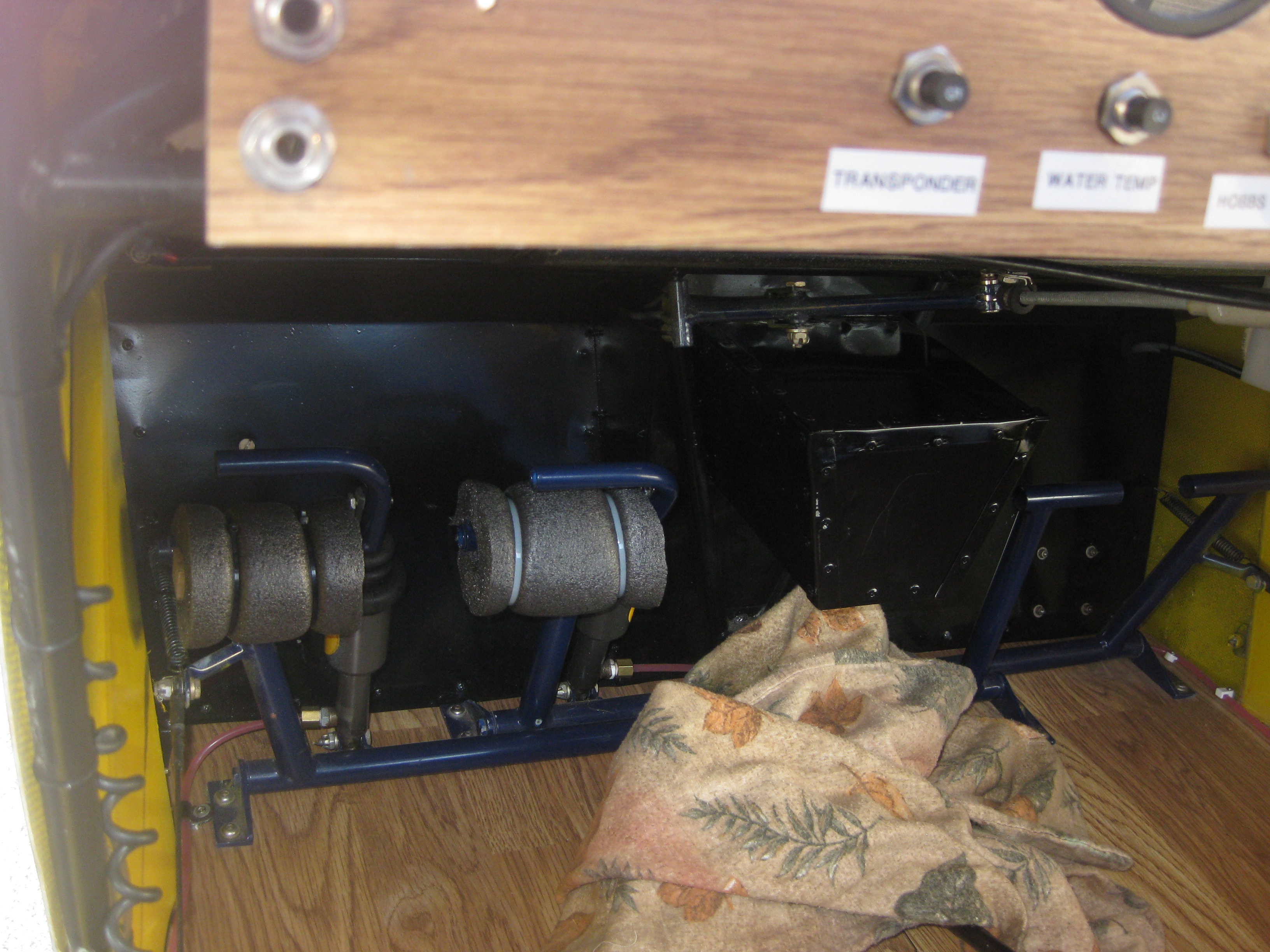

Bryan I have such big feet I have to fly with no shoes that is what the pic is from the pads for my feet but I used counter top skin from Home depot for the dash and floor to match I put it over the floor that the kit came with, it did add a pound or two but I feel it looks better,
