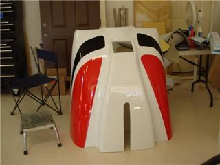

James cowl or Vans?
Is there a real difference in power or economy with the cold air
induction and/or Forsling exhaust? I understand the theoretical for
the cold air induction, and if the exhaust is better tuned, etc. Just
wondering if the final result is more speed, more climb and/or better
fuel economy, so I can sugar coat the $$ expenditure.

PostPosted: Wed Jan 27, 2010 6:36 am    Post subject: ceramic coating on exhaust Reply with quote
I have a modified Van's cowl and regular baffling. I bought this engine used
and it had the cold air induction. I have not done any scientific or side
by side tests to tell if I get more power. I know they get more power on
the dyno at Barrett than a standard set up. Fuel economy is a direct
function of power produced. At full power I suspect I burn more because of
the increased horsepower, but at cruse it should be the same.
