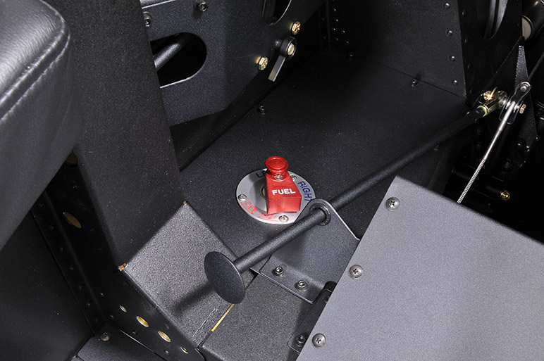

PostPosted: Wed Jan 27, 2010 9:26 am    Post subject: ANDAIR Fuel Selector Reply with quote
You can also special order a replacement faceplate from ANDAIR that has counter sunk holes that work nicely with a #8 flush head screw. See the attached photo of my RV-8 installation.
