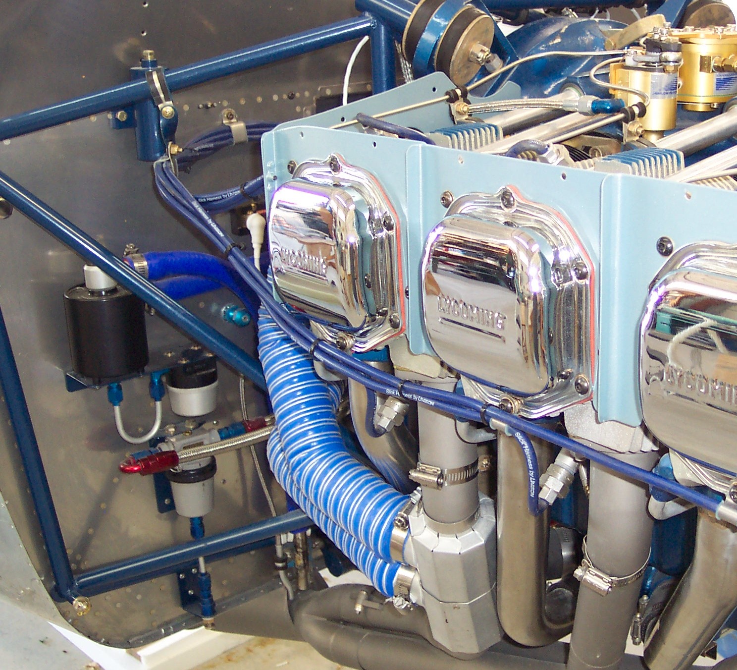

I purchased an Andair fuel check valve (non return valve)and gascolator with my finishing kit, however I am yet to decide where to position both items.
My initial thought is to install the check valve after (down stream) the Floscan fuel flow transducer in the tunnel?
Could anyone please tell me where the ideal placement for the check valve would be?
For those of you out there that have installed a gascolator (I have the Andair version), could you please indicate where you positioned the gascolator on the firewall and the location of the drain line.
Any pictures for either the fuel check valve or gascolator installations would be very much appreciated please.
Many thanks in anticipation.

Ta da!

Real nice installation FWF! What muffler and heat muff are you using?
Marcus

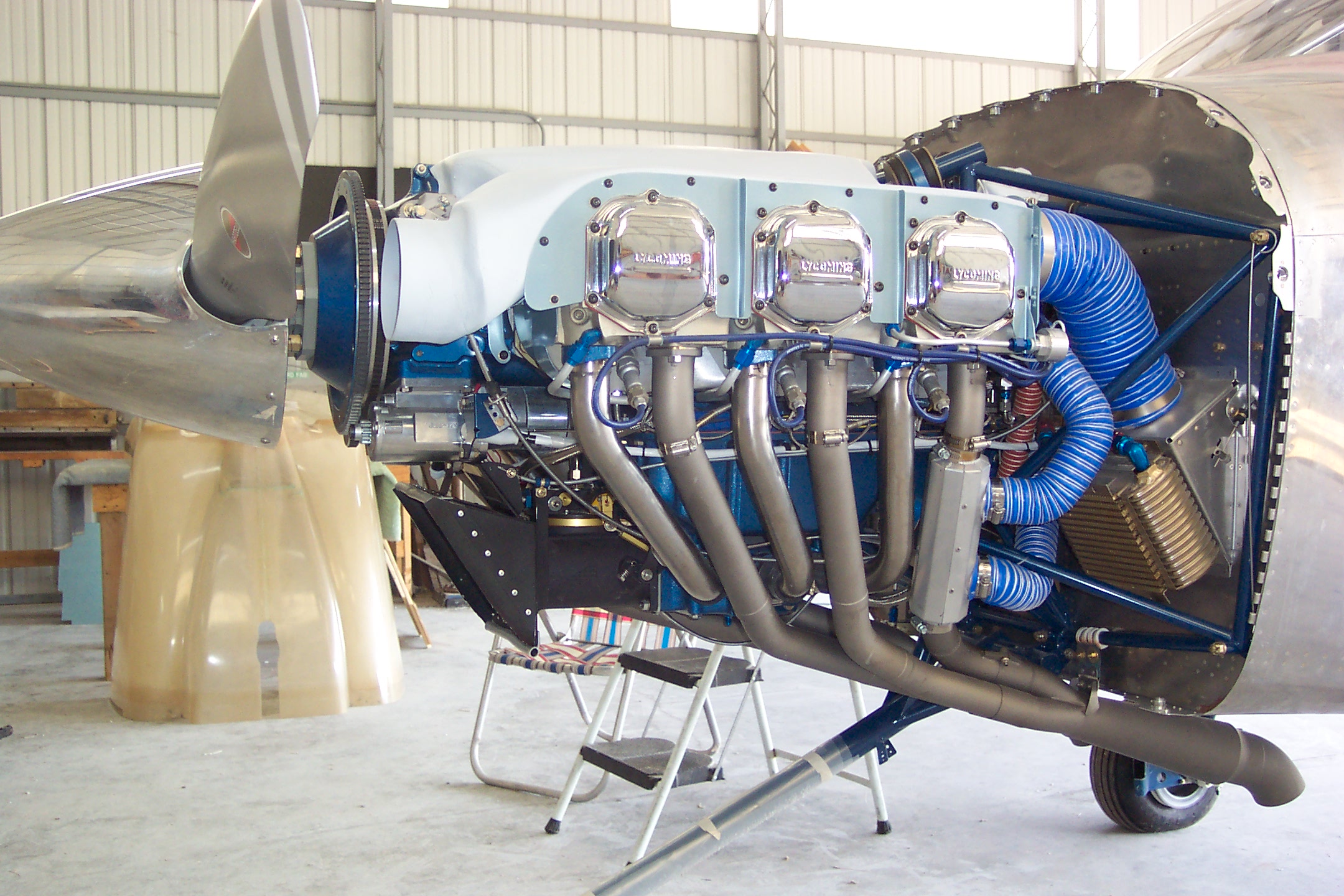

No muffler. The exhaust is a Forsling exhaust with megaphone type collector area. Looks great, sounds great. Mine happen to be ceramic coated inside and out which I would not do again.
Better view of exhaust. Photo attached.
The heat muff is a standard heat muff cut down (slightly) to fit a flat area of the exhaust on co-pilot side. Pilots side untouched as you can see from the photo.
If you want a muffler I think others are using the Vetterman system. I have seen a few and they are beautiful units too. Others can surely comment better than me on those systems.
Of note… as nice as these photos are, I am REALLY happy to be past this stage and burning 100LL and not fingertips.
Robin
