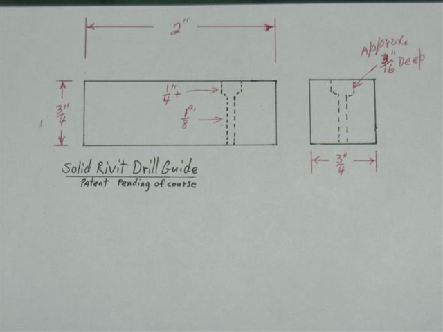

I've been working on my 601XL upgrade, and came up with a super-simple tool that allows quick and accurate drilling the rivit with no danger of hitting the spar. The outside dimentions of the block mean nothing, it's just what I had around. This block is clamped over the shop head of the rivit with swivel-pad vicegrips, or any padded clamp, and drilled through. Because the shop heads vary in diameter, the 1/4" dia. recess shown worked for a few of my rivits, and then I enlarged 1/64" at a time as needed. I drilled most of the way through the rivit, but not clear through, removed the block, re-clamped the spar,and knocked the rivits out easily with a 1/8" pin punch in the hole. Hope this is useful to someone.

I see I failed to say this block is best made from steel. (and someone caught my mis-spelling of "rivets)
