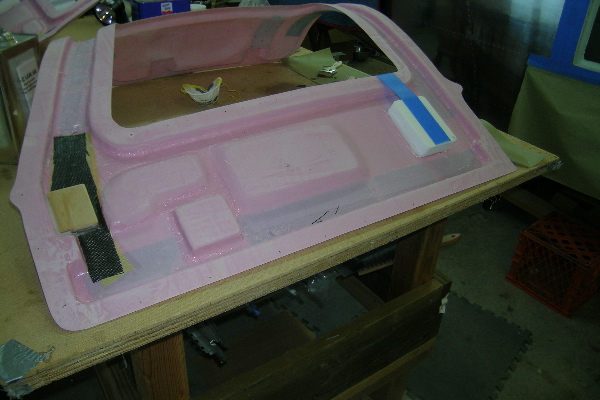

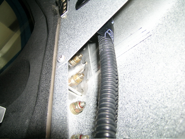

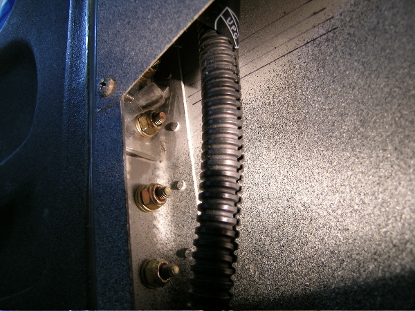

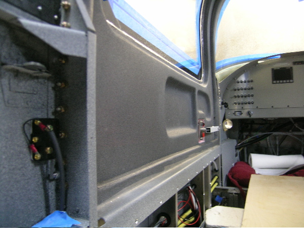

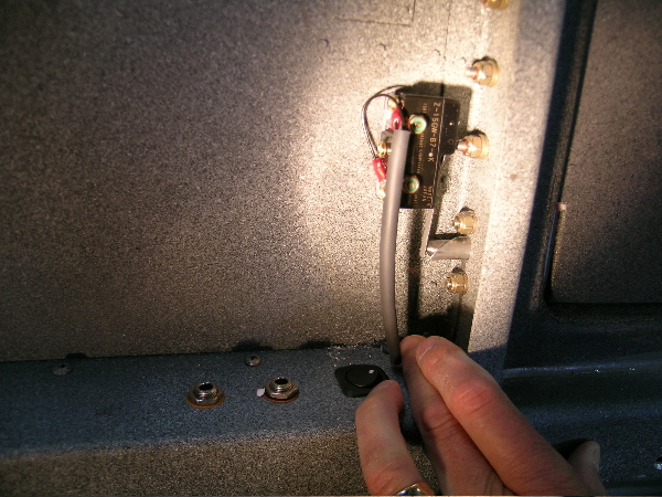

Don't mean to offend anyone C BUT
Two observations about this door latch.
I think this latch is rediculous and to me it looks like someone is playing a joke.
Imagine us getting all huffy and even rushing out to do the installation.
As it is C many people have already built their doors. There were no hardpoints built into the door in that location. The latch arm looks like it could be used on a gate holding in an elephant C but the plate holding the latch is achored into the fiberglass with blind revets and no hardpoint. Admit it C why is there this disconnect in design?
Obviously C the idea is another visual clearification that the door is closed...I guess if this latch is engaged C the forward edge of the door would have to be closed. If it isn't the slipstream could grab the door and rip it off along with the latch arm C the plate and the blind rivets. This is another assumption and may not have been tested and can't C so it is speculation on Van's part as they can't possibly know how well every builders doors close even with this latch engaged.
Secondly C could they have at least rotated the piece of aluminum that hangs out the door. I haven't spent hundreds of hours trying to make my airframe look like my slick sailplane to put this piece of 4' X 8' plywood angled 90 degrees to the wind on my plane. Glad I thought of this a long time ago and put a hardpoint inside my door on the forward edge of the door. My pins even without the aluminum billets go 1/4- 3/8" beyond the aluminum frame(not just the fiberglass cabin top frame) and I added an addition 1/8" aluminum plate to the backside of the aluminum frame to account for hole wear over the years. Yes C I also have switches C my design C from Mc Master Carr.
I made my own safety devices and am I not the builder and isn't this an experimental aircraft. Save yourselve...jump off the cliff.
