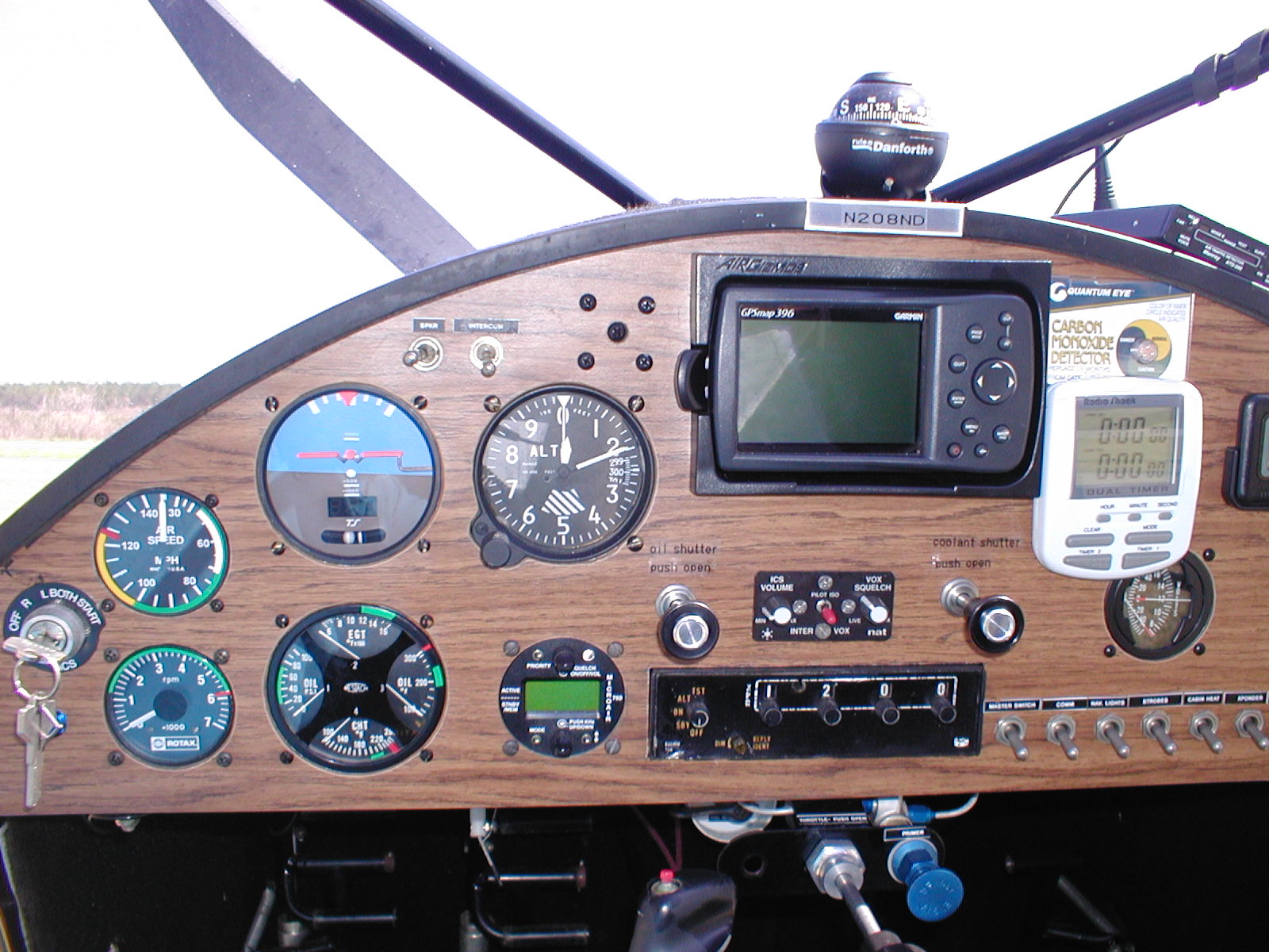

Well, I have had it with this unit. The transducer has failed again and it is less than 2 months old and less than 8 hrs !  My first one lasted almost a year. This unit is coming out of my panel and a plug installed in its place until I find something nice to put in that hole.
I removed the transducer to see what the problem was. The impeller is stuck and I could not get it to move with compressed air or Kroil. I had thought seriously of the the method of getting my prior transducer to turn (a 5 LB sledge hammer) but decided otherwise.
In any case, this piece of c--p is free to anyone that wants it, just pay shipping to my PayPal account.
Yes, I did install it correctly in the vertical position, right above my gascolator on the firewall. It was a beautiful installation.  Anyone know of a nice instrument of about the same size (2 inch) that gives OAT, flight time,etc. I would then be able to remove some unsightly stuff I have stuck to my panel.

I wonder if you are getting it hot if it is on the front side of the firewall? Or gunk out of the tank getting into it? Do you have the filter just before the transducer?
Just wondering cause I have several of them installed on my stuff and have never had a glitch, but mine is behind the seat in the plane just under the header tank.

Dick, I have a navman 2100 I think it called. I think the one you have replaced it . Mine is over 4 years old and put through over 7000 gallon of gas--ethanol regular avgas marine gas whatever. I have noticed a few times it stops fora minute or two but continues on.
Mine us mounted on front of firewall almost vertical after the gascolator. Most of my fuel goes through a filter funnel as well.
There are better fuel flow meters on the market for 300 $ up .

The transducer was located about 3 inches above the firewall gascolator inside the engine compartment against the firewall. I had it wrapped in heat shield material and it is about 1 1/2 ft from the muffler. I sure didn't see any caution about using it in in the engine compartment in the instructions. That's where it would have to go in a boat.
I removed the transducer yesterday and looked unto the interior of the thing The small rotor was "stuck tighter then a bulls ass at fly time" to quote an old buddy of mine! I couldn't move it with compressed air or a piece of safety wire. There was no trash in there I could see. The unit looked fine otherwise.
Anyway, I bought another piece of 5/16 injection hose and have removed the transducer from the system (gauge to follow) It wasn't giving me much useful info anyway. It was never accurate no mater how many times I tweaked it. Half the time the buttons would not work. I guess you get what you pay for. You must have lucked out. The net has many failures of this unit and it sure did not suprise the Northstar tech when I told him about it.There was a 5 month backlog just in replacing these transducers !
Anyway,done,nada,fine,no more of this instrument !

My transducer was mounted perfectly vertical as per the instructions and both of them failed in short order

Dick ok, just went for a quick flight
-7 C here today and still shows zero
oh well

PostPosted: Thu Jan 21, 2010 12:45 pm    Post subject: Update and Good news Re: Northstar F210 Fuel flow gauge Reply with quote
Dick,
I just in from flying , before I took off I saw something under the dash that look askew. Was the plug from the Navman hanging there LOL
plugged it back together went flying............. it works LoL
I guess you never did jinx it.

PostPosted: Fri Jan 22, 2010 5:13 am    Post subject: Northstar F210 Fuel flow gauge Reply with quote
Dick,
AAhhh Rats ! I guess it's just me that had the failures. Glad you got her running again !
        Dick
