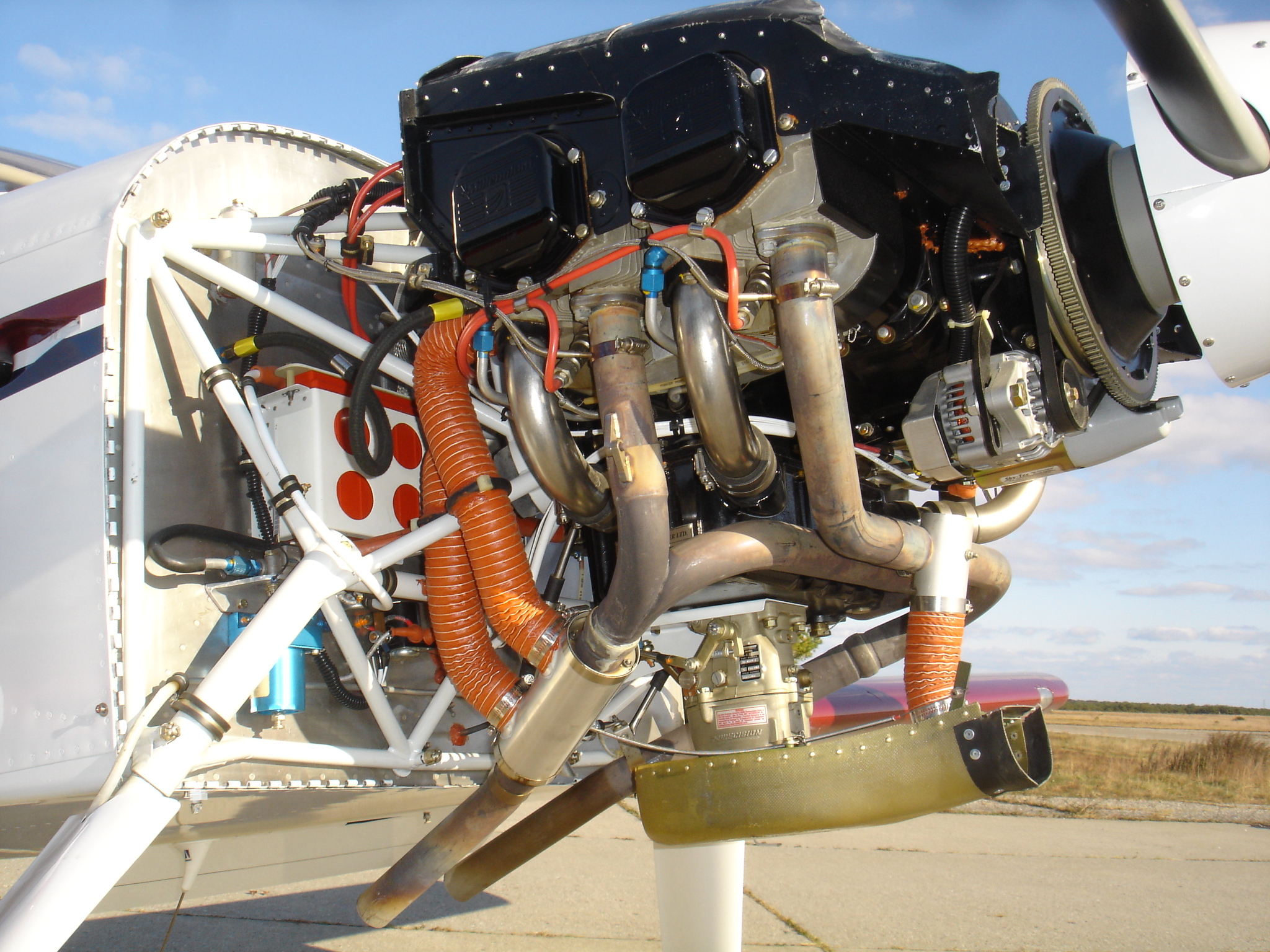

I did the steel tray with the lightening holes and have had no problems with it. The battery is not large but does have a lot of weight, so I am comfortable having the steel. You may make one of aluminum but I question how much weight you are going to save. I have tried to attach a picture of my installation.
Good luck.
Bob Bales RV6
