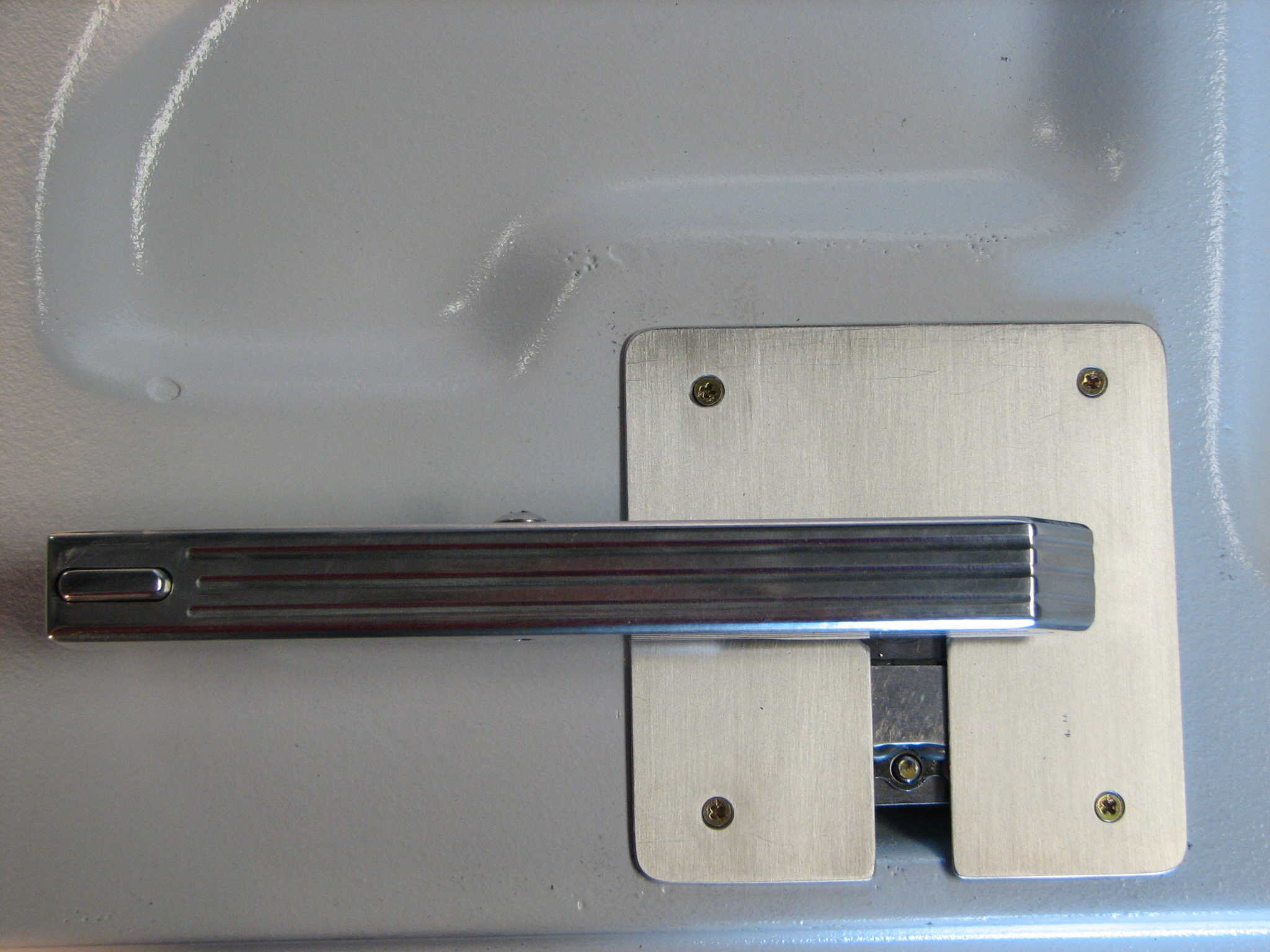

Spring for the cnc machined handles.... they work perfectly, are a direct Vans replacement, and they look WAY better.

 Filesize:  142.83 KB
 Viewed:  5046 Time(s)
