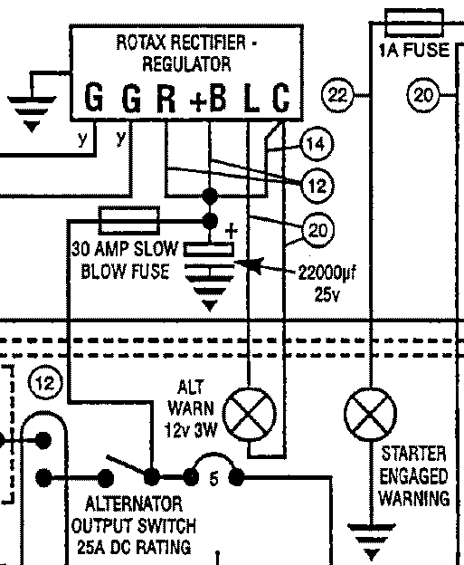

Frans - thanks for yet another way to skin a cat! I had been looking
at the wiring diagram and wondering why the wires to the alternator
warning light were not protected by a fuse, but the penny didn't drop
that they could be put to other uses.
I don't remember whether the warning light is switched to 12V or
ground, am too lazy to look it up
One end of the warning lamp is connected to the C terminal of the
regulator (also commoned with R & +B) so that better be at 12V when
the donkey is running. The other side of the lamp goes to the L
terminal which presumably is normally floating, open circuit (or even
+12V?) but drops to 0V when things go pear-shaped.
The diagram calls out a 30A slo-blo fuse to protect the 12AWG wire
leaving the C, R, +B terminals. However, there is NO protection for
the 20AWG wire leaving the same spot and going through the firewall
to the alternator warning lamp. I presume the wire itself is intended
to provide the smoke if it gets chafed to ground at the firewall! I
think I will be fitting a fuse.
regards
Rowland
regulator (also commoned with R & +B) so that better be at 12V when the
donkey is running. The other side of the lamp goes to the L terminal
which presumably is normally floating, open circuit (or even +12V?) but
Well, you don't have to connect the lamp to the C terminal, any 12V
connection would be fine. I have mine connected behind the master
switch, and behind the panel fuse. The only wire going to the alternator
controller is the L wire, which doesn't need a fuse at all.
About the hobbs: Connect the + of the hobbs to the L wire (either end
would be fine, but the end near the bulb would be practical). Connect
the - of the hobbs to ground.
This will cause the hobbs to run as soon as the master switch is on,
unless the bulb lights up. So, it will effectively count the engine hours.
That's really all there is to it. No need for oil pressure switches or
other gadgets.
leaving the C, R, +B terminals. However, there is NO protection for the
20AWG wire leaving the same spot and going through the firewall to the
No, because you are supposed to connect it behind the fuse. The 12AWG
wire is connected to the C terminal, so instead of connecting the lamp
to the C terminal directly, you could as well use the other end of the
12AWG wire. 12 Volts is 12 Volts after all. Wink In fact, any 12 V line
would serve the same purpose.
You should indeed not connect any unfused wire to the C,R or B terminals!
Hope this is clear now.
Frans

PostPosted: Wed Jan 20, 2010 2:25 am    Post subject: Oil Pressure Switch for engine hourmeter Reply with quote
Frans - I agree with your last sentence completely, but here is what the diagram I've got shows:
[img]cid:a06240800c77c835dfb6f(at)[10.0.1.2].1.0[/img]
I don't usually paste graphics into my e-mails so am not sure if this will get through to the list unmangled.
If the graphic is not visible in this e-mail, you can see a copy of it at:
http://home.clara.net/rowil/grafix/alt_warn.gif
You can see that the wire to the starter warning light does have a fuse, so why not the wire to the alterntor warning light?
I think Mike Gregory was involved in the last modification of the diagram in the manual. Mike, if you're listening, have you any comments?
I postulated 2 scenarios for what happens at the L terminal of the regulator when all is well (open-circuit or +12V) and am still not sure which is correct. Either will of course serve to supply the engine timer through the warning light, but if L is held at +12V, I feel the lead from it should also be fused.
Maybe someone who's taken apart one these regulators might know what potentials should appear at the L terminal.
regards
Rowland

jan_de_jong(at)casema.nl
PostPosted: Wed Jan 20, 2010 6:29 am    Post subject: Oil Pressure Switch for engine hourmeter Reply with quote
Hi Rowland,
In 2008 I found a German language forum discussion concerning the Ducati
regulator. Writer "Arrow" seemed to know what he was talking about.
I reported -
http://www.sarangan.org/www/mhonarc/mharc/html//europa-list/2008-08/msg00133.html.
The 2008 entries have been removed (Rotax did not like them probably)
but I saved the page from cache where you can still find it too probably:
google using "piloten arrow ducati regler".
If not I will attach (34 files, 425 kb).
In any case there is a circuit diagram and it shows L as shorted to
ground via FET when C gets above some voltage, otherwise floating.
Jan de Jong

PostPosted: Wed Jan 20, 2010 10:32 am    Post subject: Oil Pressure Switch for engine hourmeter Reply with quote
At 2010-01-20 15:14 +0100 Jan de Jong wrote:
there is a circuit diagram and it shows L as shorted to ground via
Jan - thanks for that, very useful. It's what I would have expected,
but sometimes these things are done in a different way to my
imaginings!
PostPosted: Wed Jan 20, 2010 1:00 pm    Post subject: Oil Pressure Switch for engine hourmeter Reply with quote
but sometimes these things are done in a different way to my imaginings!
regards
Rowland
I should have said, actually: when average input voltage (G's) gets
above some level, which requires C powered (which by itself only
provides a bias current).
Jan
