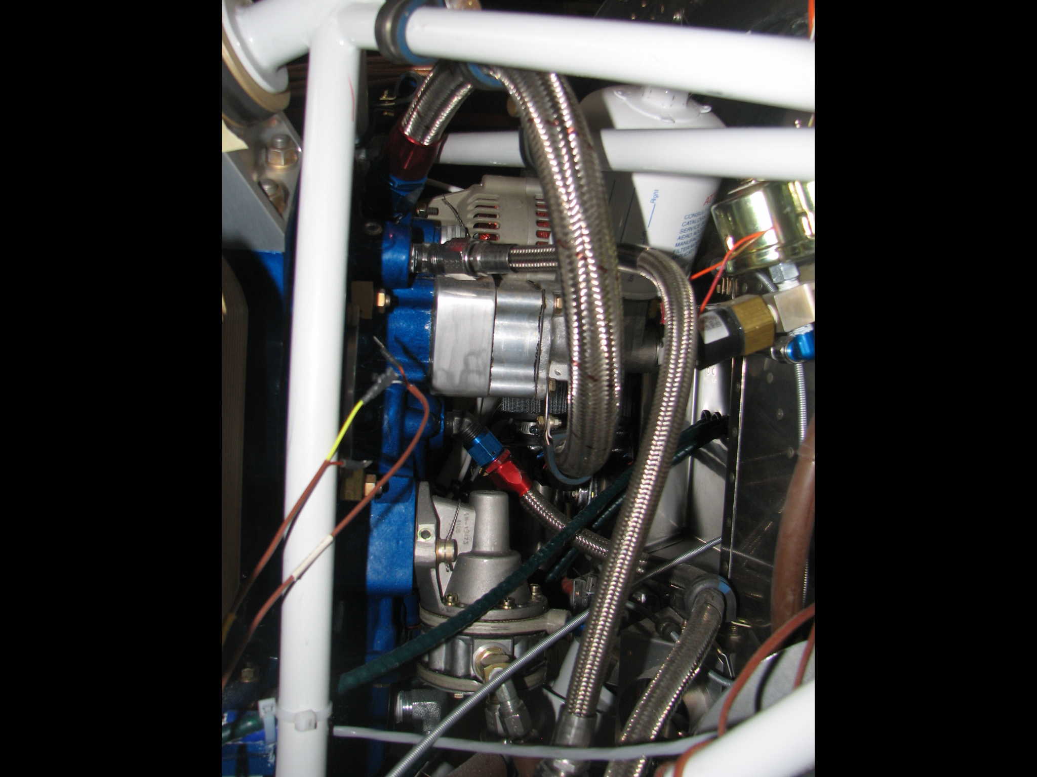

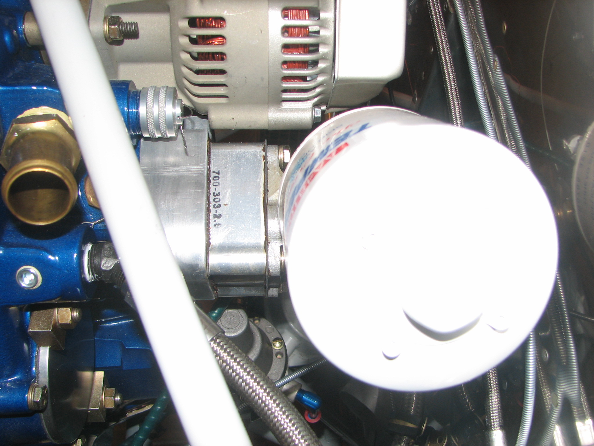

PostPosted: Wed Jan 13, 2010 6:07 pm    Post subject: oil adapter spacer Reply with quote
Dave, I was a real newbie when I ran into this issue.... and I didn't know the matronics board existed... Anyway, I made my own adaptor which attatched to the engine, and a second, stock, adaptor went on next. It looked to me that the mount needed to be both spaced rearward and offset. It appears to have worked.... engine performing beautifully, with all the right pressures, for over 100 hours.
