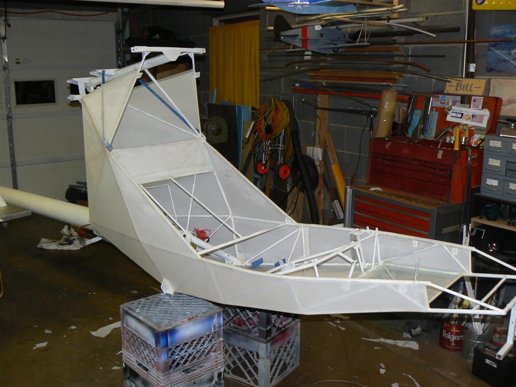

Since some of the Kolbers asked for me to post pictures of the ongoing repair job, here is the fuselage covering in it's almost finished condition.
Something I learned last night is how to get rid of those annoying little brown bumps of sharp or prickly glue that form along the tubes after you work the fabric down smooth with the hot iron. Just go over them quickly with the brush full of MEK, just enough to wet the surface, and then rub them with your fingers. They either smooth down or rub off.

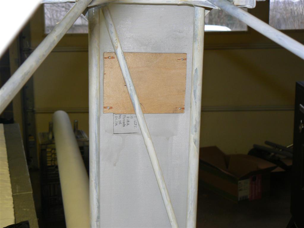

This is a piece of 1/16" plywood predrilled for the data plate. It is glued to the inside of the fabric. It will get reinforced across the outside with tape.

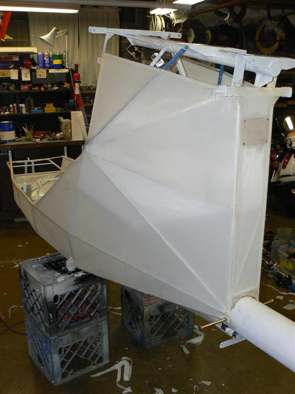

Here you can see where the data plate will go, and also the silhouette of the storage area.

Right side.

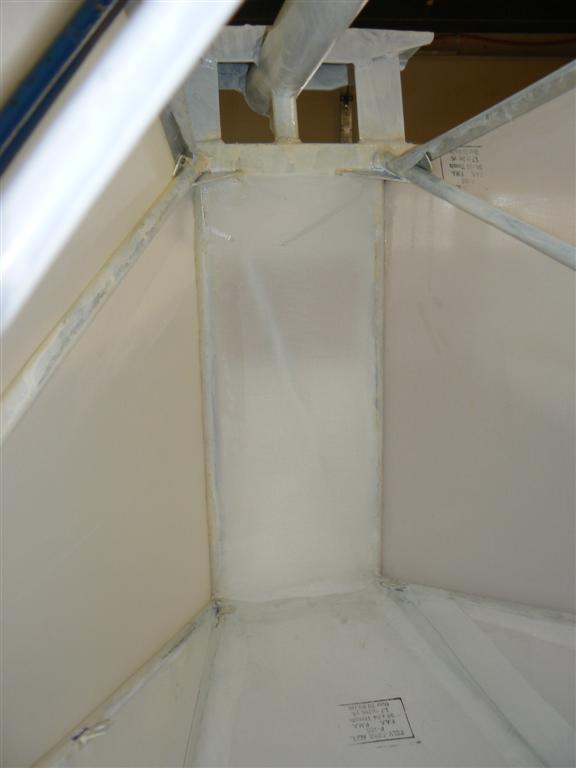

This is how it looks inside after the inner covering of fabric goes on.
