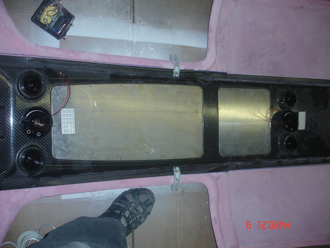

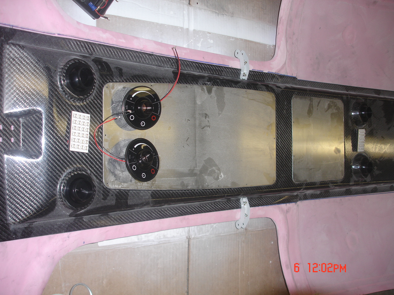

I need some pro-builders, that's all of you on the list, to help me
with my lights on the overhead. Pilots that have flown the 10 or
pilots that have flown a lot of other planes I need your advice. That
includes you Tim and Robin. I want all feedback I won't get my
feelers hurt. I don't want to punch unnecessary holes in my overhead
console. I have two configurations below but not limited to these.
Also, I will make some bezels for the LED's.

First off, it looks good either way. I have a Accuracy avionics
overhead. I have a couple small LEDs fairly far forward, up by the four
nuts holding the center bar. I have done some night flying recently and
it seems that the sun visors will sometimes obstruct the light access to
the panel. Farther back may be better, for what it's worth.

I'd really recommend the dome light for up front, and one
in the back if you wish as an option. The one in front
is very handy. My click-lights work in the back OK for
the kids, but if you wire up one, you could just as easily
wire up the second for the rear seat.
Then, for spot/moveable LED's, I'd really recommend that
the front have TWO of them, and that they be moveable.
I find that I could even use 3 if you want full lighting
on everything up front. What I usually do is when we're
in cruise, I dim everything as much as possible, but turn
my 2 overhead red lights so that I can see all the panel
switches well, and the co-pilot side is on the throttle
quadrant area. I leave the side by the breakers only
dimly lit...nothing aimed at them. In an ideal world,
I would have a left, right, and center. But you'll
want all switches to have some sort of illumination
to make them visible at night. don't find that a
glareshield light would do a fantastic job of lighting
switches down on the bottom of the panel without it being
really bright, and I don't like any bright lighting in the
cockpit at night. I dim the EFIS's, and everything else
to the minimum.
So, with that in mind, I like the photo with the 2
eyeball lights best. You may want eyeballs in the rear,
too. I put some lighting back by the rear air vents
that seems to be OK for the girls....although I
should probably make it brighter than what have today.

Sean,
Are those your only lighting on the overhead?
The reason I ask, is that I really like what Geoff did in his overhead. He
has an eyeball type of light used for map/task lighting for each passenger.
He has two of Stein's cockpit lights (B-12) mounted on the forward portion
of the overhead to wash the instrument panel, and one the dome lights that
Van's sells in the front and back seats, and two in the baggage area for
maintenance/cleaning.
I think this strategy of three different types of lighting is pretty
effective.
I'm sure you can talk Geoff into sharing a photo of his installation.
Ironically, he doesn't have one of his own overheads. That project didn't
start until his was almost ready to fly.
bob

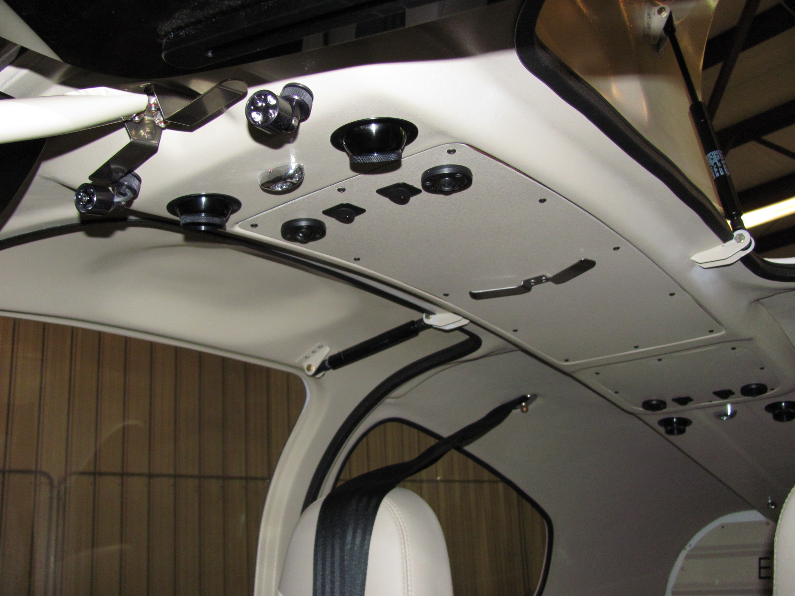

Sean here is a picture of what I did. So far I really like the setup. Each
passenger has there own LED reading light eyeball from Stein. Small but
works good. Those have there own on-off switch next to them. I then have the
small silver dome lights in the cockpit area, passenger area and then 2 in
the baggage area as my dome lights. Last I have the Blue LED adjustable
lights that I can shine on the panel or turn down to the pilot or copilot.
Although I do not have a lot of time in the airplane this seems to work
well. I like the idea of putting as many of the lights in the removable
panels so if for some reason a really cool light comes out that you have to
have you do not have hole to fill in the overhead just replace the panel
insert or fill it and repaint. The only problem I have is I cannot get my
head sets on the head set holders in the front as planned. The lights I
placed to close in. I had them mounted before I decided to put the head
Set hangar in. All you need to do is move them out as far as possible.
Hope this helps

I really wanted the Aveo's but your experience has started to turn me
off. (... and save me money)
Now I'm leaning toward Stein's lights (2x) front, (2x) rear, 1(x)
baggage. I'm planning to us a off/on-dimmer in the front for each light
and the same thing for the rear seats. That makes a total of four
off/on-dimmers for local control.
But, I'm also planning to install a master (read "Kiddie") switch for
the rear lights. So I can shut them off up front and don't have to
worry about a kid flipping on lights unless I want them to. If I were a
kid, I'd do it just to make dad turn around and slap me... I know how I
thought.
The baggage light will have its own pair of switches.
1) Local in the baggage compartment to help during
loading/unloading.
2) Cockpit switch: So mom can crawl back there in flight and dig
through bags for diapers, bottles, and band-aids. Smile
Phil

You'll want the rear seaters to have SOMETHING other than
a bright light. We won't let the kids use any bright
lights in the back during flight. Red, Blue, whatever...
you won't want it bright. Having those 2 Stein lights
forward sounds like a good idea...then you can do
whatever you want overhead. I find I can reach up and turn
those forward lights to my lap if I need them....so other than
the white dome, I don't have anything separate, and don't need
it. I keep a 2 color (white/red) flashlight by each pilot
seat too.
A baggage light will be handy. I used a click-light back
there too. One less pair of wires to run,and when
you're unloading you don't need to leave a master on
or worry about leaving a light on if you directly tie
it to a battery bus. Click lights can be very handy since
they're bus independent.

Geoff Combs wrote:
[quote] Sean here is a picture of what I did. So far I really like the setup. Each
Hope this helps
Geoff

One other thing I forgot to mention was I used TCW's intelligent lighting
system and it is awesome. My Dome lights can be dimmed as well as the front
blue lights. The dimmer is the on-off switch as well. It has the wig wag.
Easy to install. It also dims my switches and what ever else you might need.
Geoff
