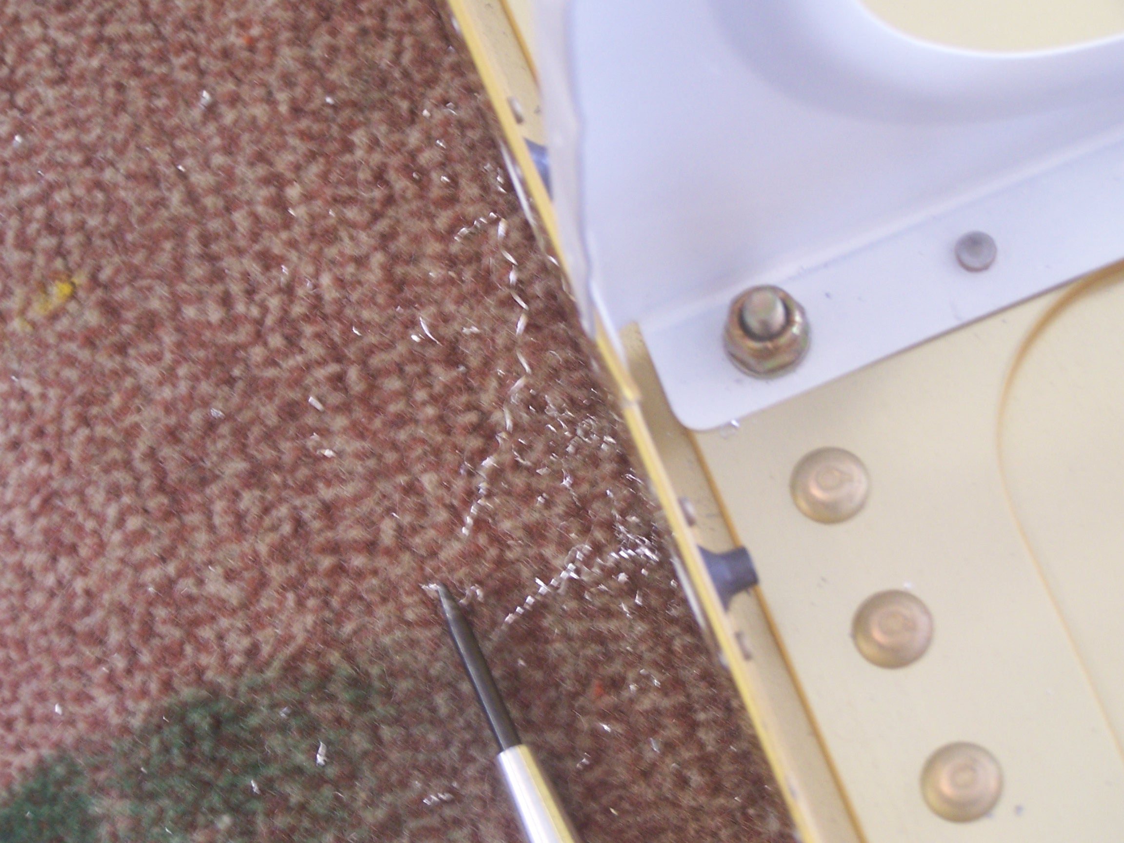

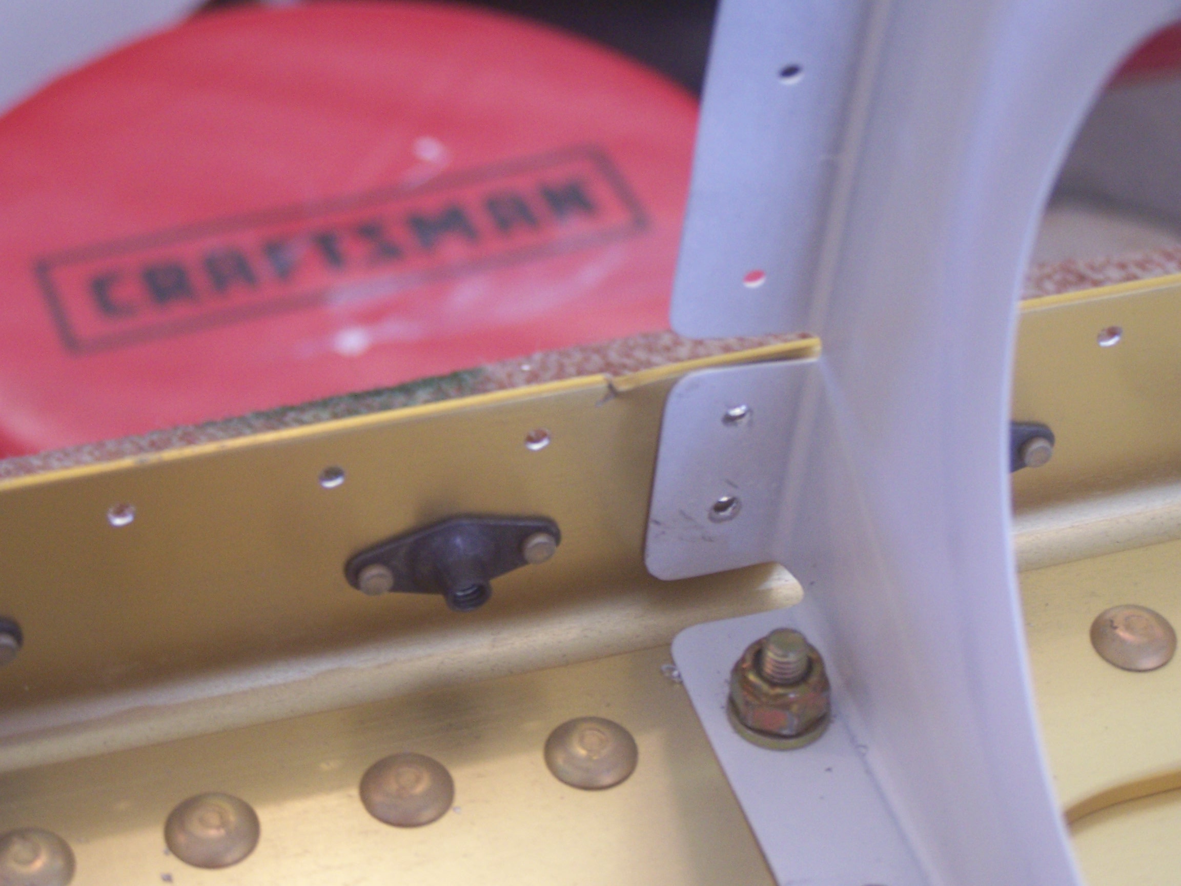

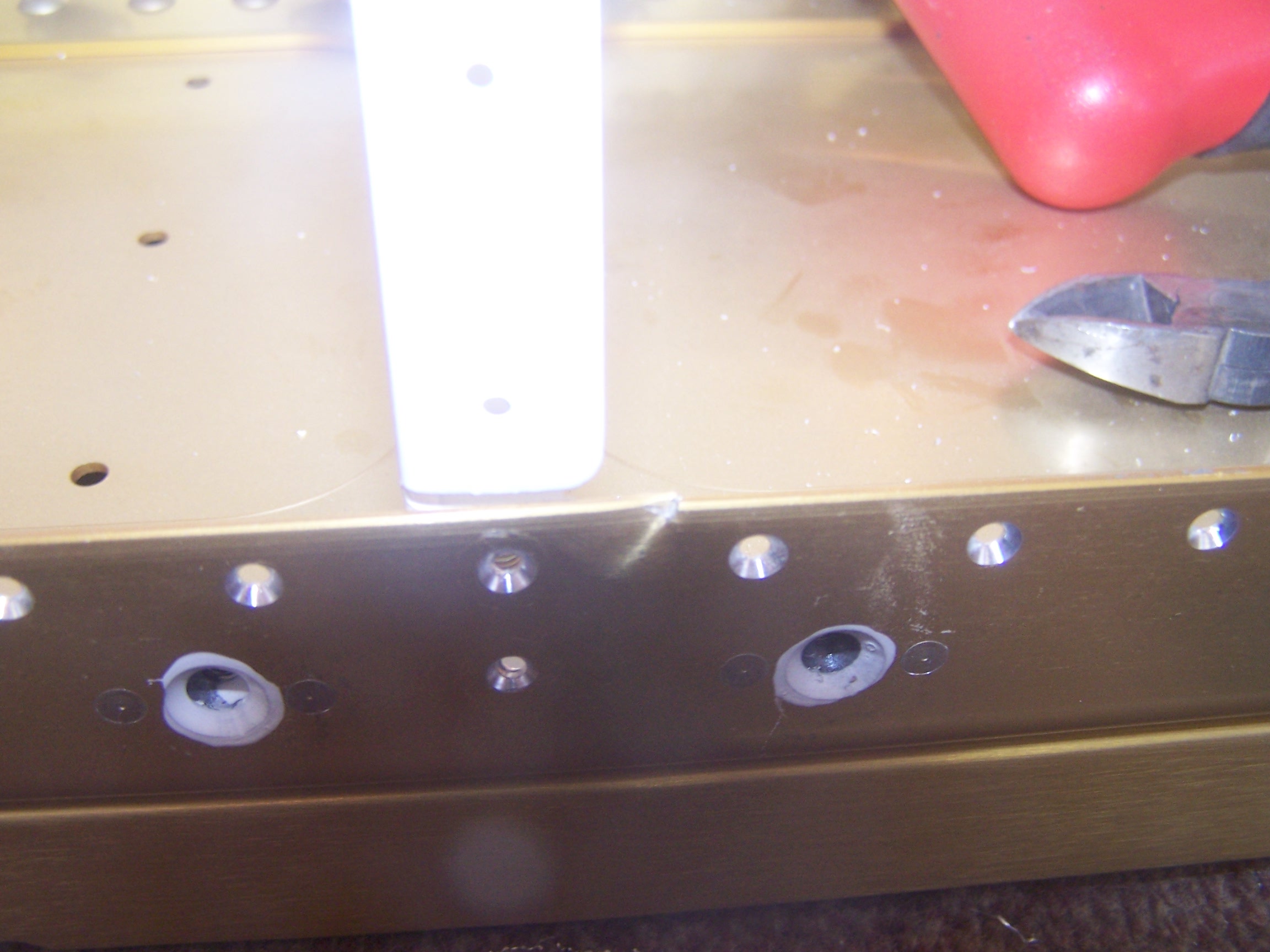

I think I might have messed up pretty good this time. Working on the wings on pages 14-5 or 14-6 we are to rivet the forward most hole on the flanges of the inboard most 7 W-1011 L,R ribs. While doing this I had a less than acceptable rivet so I drilled it out. When removing the shop head (via punch/small mallet) I managed to push the rib flange away from the spar flange a little. So, this is where I hopefully learn my lesson, I tape the jaws of a pliers up to prevent scratching the spar/rib. I easily squeeze the pliers on the flange and it nicely pulls it back into place. However, I realize when I 'm done that the "cutters" on the pliers nipped the edge of the spar flange. Left a nice little "cut" on the edge of the spar flange (top flange--didn't count exactly where it was but outboard about 6 or 7 ribs from the inboard most rib). Lesson here--don't use pliers on aluminum--I know now. Question--pics are attached--before I contact Vans does anybody have any suggestions/advice. Did I ruin the wing spar?? Do I leave it alone? Do I file it smooth and leave it? Do I use a scotchbrite wheel and remove a smooth "notch" section to get rid of it? The "nip" is somewhere between 1/16 and 1/8 inch long.
Any suggestions appreciated other than telling me how stupid I am for doing it. I have learned my lesson.

Yep, call Van's. However, my guess is you'll be OK. I think the fix would be something along the lines of stop drilling the "cut" and the filing it smooth, possibly to the point of making a notch similar to what we all did back on the tailcone longerons. But don't do anything until talking to Van's.

Now that you have polished it up C you could either prime it or better C put a gob of proseal or other flexible bonding medium between the skin and the spar flange when riveting. This will be your corrosion inhibitor. The spar is not alodined C it is anodized. Two different processes.
There is no way the skin with the rivet holes in their locations would impart enought strain into that flange to start a tear in the spar flange.Basically C that flange is a tie in point for the skin just like Vans said C the spar is a stout piece of metal and it would need to twist so much before the that crack started that if it did C the wing skins would look like a stepped on aluminum can and the plane would have already hit the ground.
Remember aluminum planes flew with bullet holes in them.
Great to be safe but this look like a very small BOO BOo. Ease your mind.
Thanks in advance,
Bill

Thanks to everyone for the information. As I stated earlier, Scott at Vans
said it wasn't a huge deal. He said to grind or file the area back smooth.
Make sure all the "cut" is gone, smooth it out and move on. I have that
done and need to prime over the exposed aluminum and it will be history.
Thanks for the tips on holding the flanges in place while riveting.
