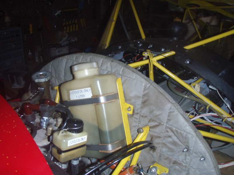

Sorry about the somewhat low quality of the pictures but my plane lives in a little cubby in the garage and it is too Fn cold to drag it outside. Mine is mounted at an angle at the top of the firewall between the radiator plumbing and the fuel pump. I hope this helps. I did not do this install but it looks to be by the books from what I have seen in the builders manual.

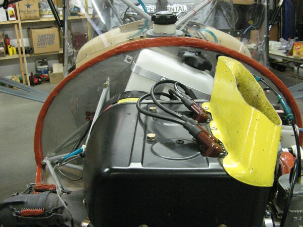

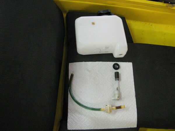

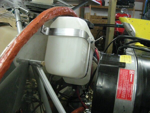

Here's an update on what I did. I also have a couple more questions about mounting the oil tank. My builder's manual is for a 503 and does not cover oil tanks.
Attached are three photos. The tank is from a Ski Doo. the price was right and it came with all the fittings and a low level warning float and switch. Notice that there is a "Sump" that the bottom fitting sits in.
I notice on the photos I have seen of the rectangular tanks on Kitfoxes that they are mounted at an angle. I figured this was to make one bottom corner a low point for the fitting to prevent unporting. So, I mounted my tank at an angle with the fitting being on the low bottom corner.
I looked at those photos again and see that the one Dave posted a link to in another thread http://www.rotaxaircraft.com/forum/download/file.php?id=210&mode=view shows the fitting is on the high bottom corner not the low one. I can't see the fitting in the photo James posted above so Now I am wondering about this.
Can someone with a manual that covers this take a look and let me know what it says about this, if anything.

PostPosted: Thu Jan 21, 2010 10:23 am    Post subject: 582 owners show me some Oil reservoirs Reply with quote
Tom, My rectangular tank has the outlet in the middle of the bottom. I mounted my tank slightly on an angle. I did so because that is where the mounting bolts would fit through the firewall, be accessible and miss the frame..

PostPosted: Thu Jan 21, 2010 12:02 pm    Post subject: Re: 582 owners show me some Oil reservoirs Reply with quote
Tom, My rectangular tank has the outlet in the middle of the bottom. I mounted my tank slightly on an angle. I did so because that is where�the mounting�bolts would fit through the firewall, be accessible and miss the frame..
Pat Reilly
Thanks pat. I think I will redo mine so it sits level. I got to thinking about the outlet unporting and realized the oil will stay put across the tank if I fly coordinated anyhow. Besides, the sump where the outlet is will hold four ounces, if half spills out of that I still have about 10 minutes worth of oil over the outlet.
