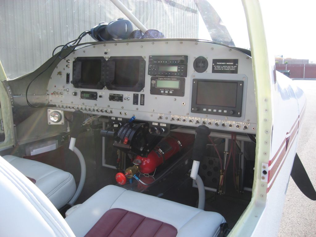

builders who are considering the possibility of fire under the cowl should consider a fire bottle. Stroud in OKC sells them and relatively easy to install.

PostPosted: Sun Jan 03, 2010 10:07 am    Post subject: FWF hoses Reply with quote
Hey David,
I was looking at yours at OSH…
Do you have any FWF photos? Where does it spray to?
Phil
