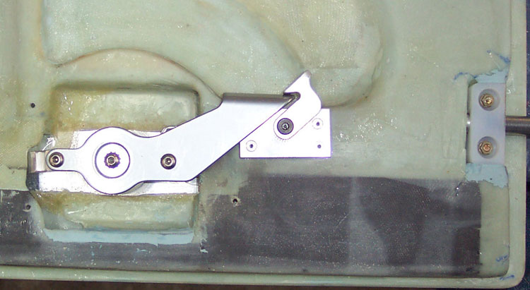

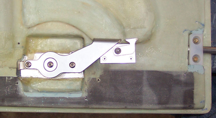

Speaking of doors......I am installing mine at this time. After reading a lot of write ups on the doors my father and I have been looking at a third pin for my doors. I have been building the plane in my father's machine shop. I told him about the doors coming open in flight and he has worked on several different ways to make a third pin or latch that actuates with the stock handle. He has been successful making some test models that would work. So as time went on we have had the opportunity to look at Scott's RV. Scott has done a beautiful job with his plane and made the doors work like they are supposed to. He also installed the prox. switches to show the doors are fully latched. After my dad and I went out to Scott's hangar and on a few flights with Scott we decided that it is not necessary to make the third pin. If the door is not latched, the light is still on. Pretty simple. Now if my doors don't come out as good as Scott's did, I may add one. One good thing about the stock door handles are the locking mechanism on the handle to avoid inadvertant opening. I notice after market latches don't have this lock but look a lot nicer than Van's. Robin came up with a fix for this also.
If builders and flyers out there think I'm crazy and I should make the third pin please tell me why. I am looking for a reason to build these.

PostPosted: Sun Jan 03, 2010 7:20 pm    Post subject: additional latch for 10 doors Reply with quote
Sean,
Regardless of the door handles, I'd like to enter my vote as to
you being crazy. Definitely a "Yeah" vote to that one.

PostPosted: Sun Jan 03, 2010 9:55 pm    Post subject: additional latch for 10 doors Reply with quote
Thanks Sean,
            I would not call my patch a “fix� but rather “another thing to get in the way of inadvertent unlatching.� My “add on� gives me much greater security but they are not the solution. I think the third pin concept has a lot of merit and I saw someone’s design that seemed like a slam dunk with minor redesign to the pivoting part of the handle (lousy description). HOWEVER the "Staniforth latch" solves a problem the third pin can never solve. Inadvertent unlatching. There is mechanism failure and inadvertent unlatching I bet the WHOOPS especially from the PAX side is a real possibility. If someone accidently unlatches… that’s goodbye gull wing. I guess I have to give a shout out to Jessie’s strap, that will hold the door in place too and probably the easiest retrofit. That is why I like the Staniforth latch. Problem solved. Thanks for the write up Andre.
My non-solution, solution.
Note: these same mechanisms with the latch handle in the proper orientation (arm pointing out) are an accident waiting to happen by just catching on a sleeve. Turned pointing in reduces the chances significantly. Adding the leaver lock gets you even further down the road.
Robin
From: owner-rv10-list-server(at)matronics.com [mailto:owner-rv10-list-server(at)matronics.com] On Behalf Of Seano
Sent: Sunday, January 03, 2010 7:00 PM
Subject: Re: RV10-List: additional latch for 10 doors
----- Original Message ----- .
From: Roxanne and Mike Lefever (roxianmike(at)msn.com)
Sent: Sunday, January 03, 2010 7:38 PM
Subject: RE: RV10-List: additional latch for 10 doors
Yes i recall. I am considering attaching it to the existing push rod so it would open from the outside with the existing mechanism.  Just am hoping someone smarter than I has already done the design.

PostPosted: Mon Jan 04, 2010 9:22 am    Post subject: additional latch for 10 doors Reply with quote
There are some important factors for the door mechanism:
Lightweight
Emergency exit - if the plane is on fire you want the pax to easily open the door
Strong - there is some mechanical leverage on the main handle
Ease of use for passengers to close the doors without a long explanation on how they work - part of the breifing
Be maintainable
The third pin we designed is a little heavy. It would add a little weight to the doors and might require a stronger gas strut. It is also expensive. It would cost about 200 bucks for materials alone from Vans' price sheet do fit both doors.
