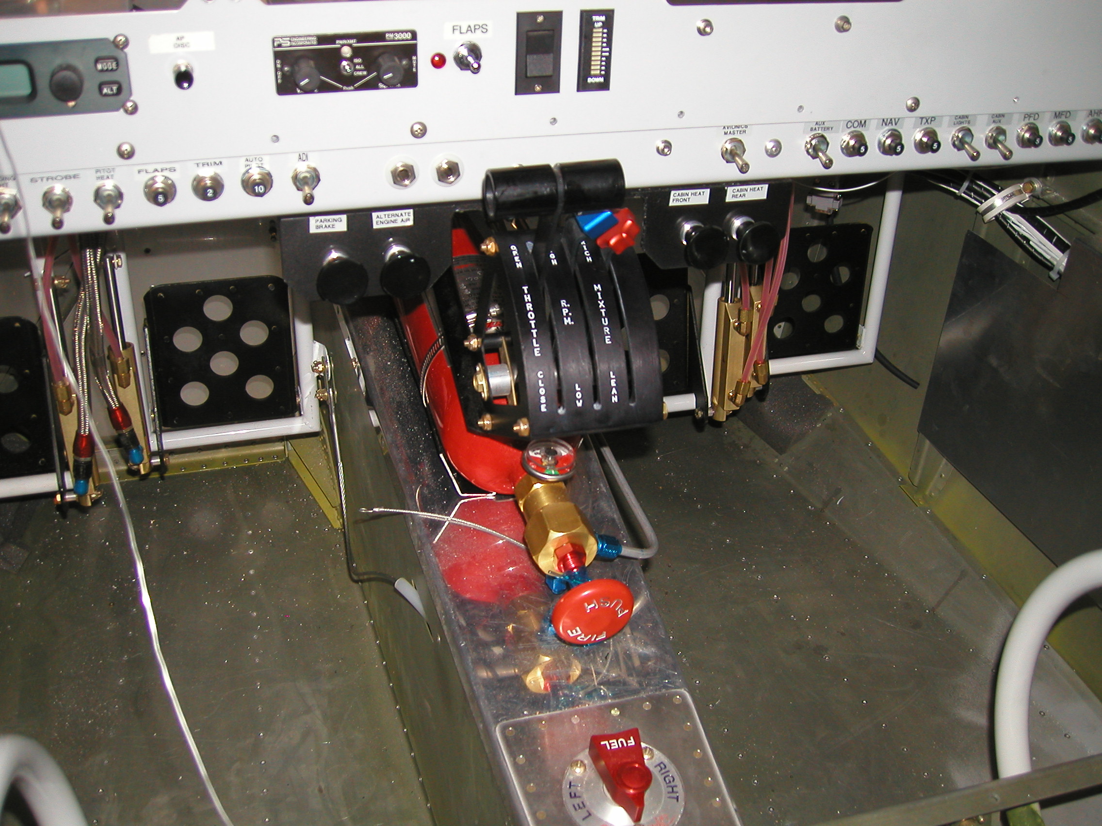

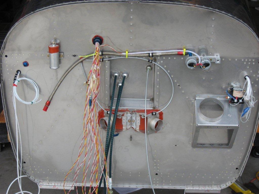

One picture shows the location in the cabin, the other shows the location on
the firewall. Note the blue fitting between the red/yellow/white wire bundle
(EGT/CHT wiring). That is the bulkhead T fitting through the firewall. From
there hard flared lines use the sprayers provided in the kit to spray Halon
behind the aft cylinder baffling; one hard line is routed through the aft
baffling and sprays over the engine. Because my engine is not carbureted, I
do not plumb a line to the carburetor box. On my Glastar, one lines sprays
the top of the engine and one line is plumbed to a bulkhead fitting in the
carburetor air box. That fitting inside the box is capped and a #40 hole has
been drilled in the cap.
If you install a carbureted engine I recommend a pinhole plumbed
inside the carburetor box. This eliminates most damage done by carburetor
fires. Halon leaves no residue and requires no clean up.
