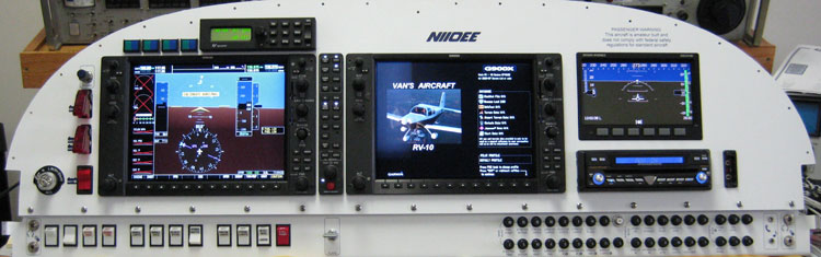

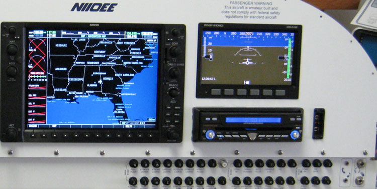

5
6
7
8
9
5
6
7
8
9
 Filesize:  55.02 KB
 Viewed:  11671 Time(s)
 Filesize:  75.82 KB

PostPosted: Tue Dec 29, 2009 9:54 am    Post subject: suitable backup instrumentation for IFR Reply with quote
One thing I would add is that whatever backup you decide on, it's important to place it in a position that's easy for the pilot to use.  If the day comes when you really need that backup, it's going to be a stressful situation and you'll want as much as possible in your favor.  It's tempting to place the backup in front of right seat, but if you don't have a great view of it, it might as well not be there.
A D10 or ADI would be marginal for the pilot if optimized for the right seat.  I'd hate to fly an approach on the backup in any case, and having it way out of your field of view would make it even worse.  I placed my D10 immediately above and to the right of my primary, like this:
http://www.advanced-flight-systems.com/Installations/SaylorPlan.jpg
