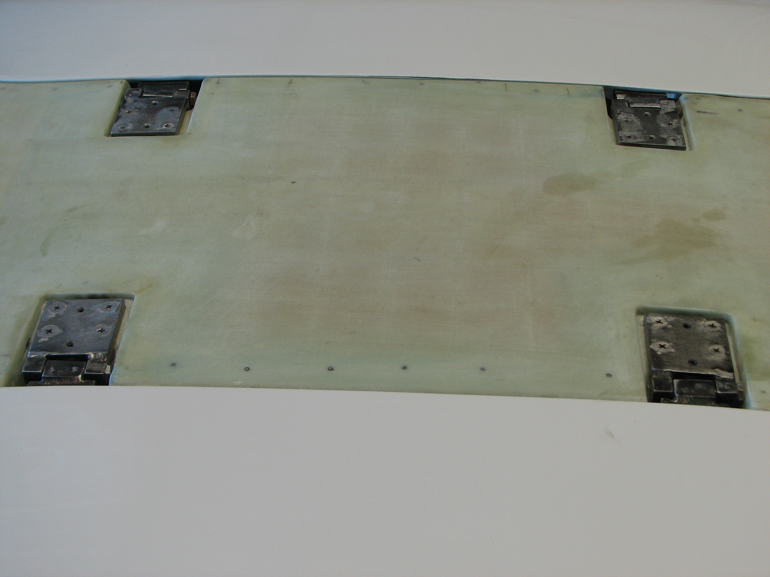

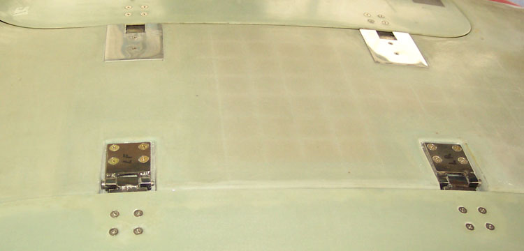

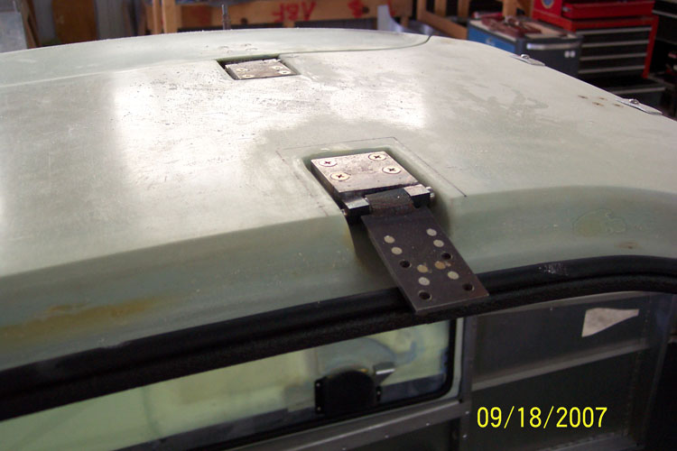

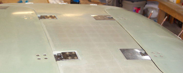

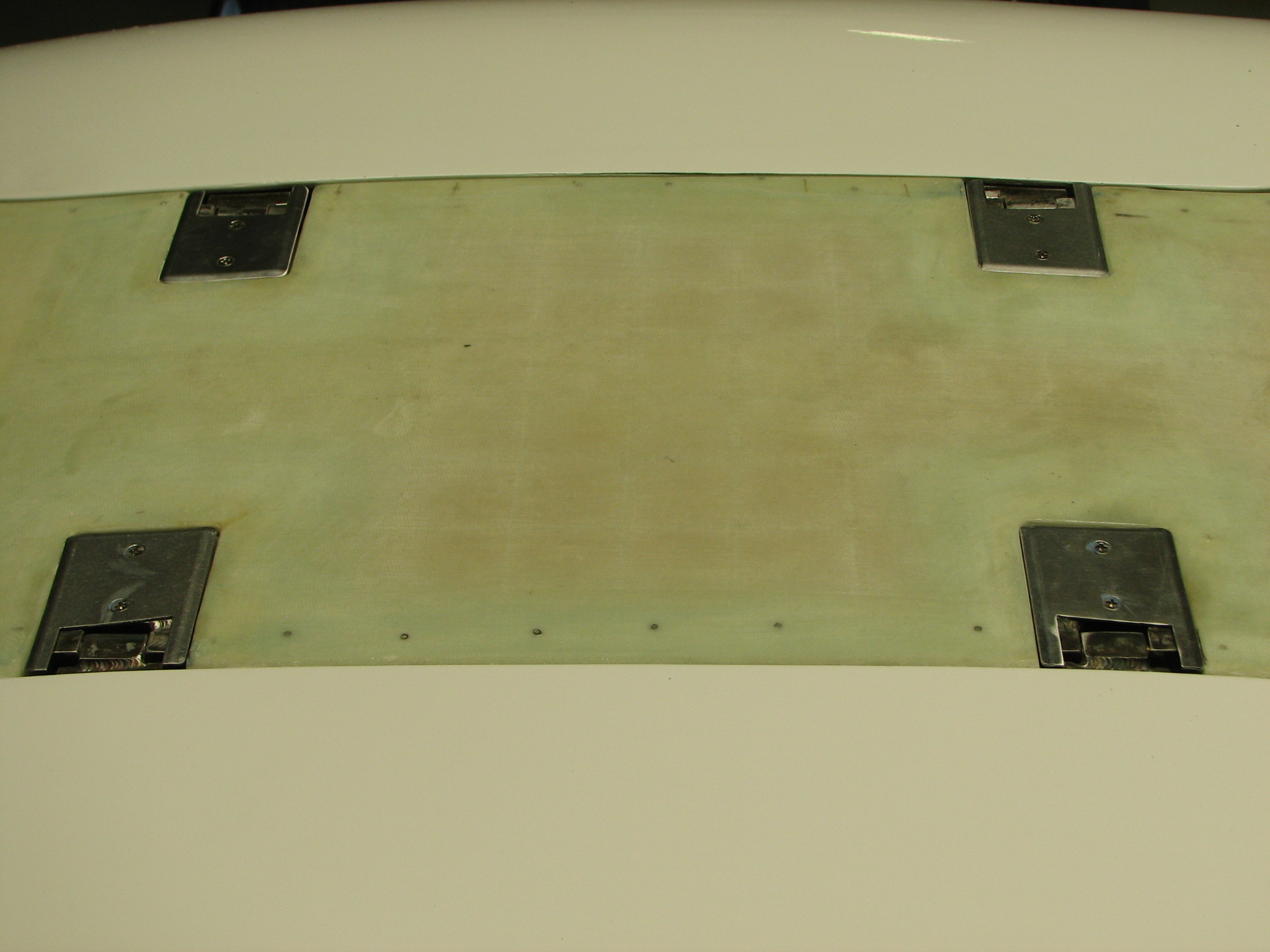

PostPosted: Sun Dec 20, 2009 5:48 pm    Post subject: Door Hinges Reply with quote

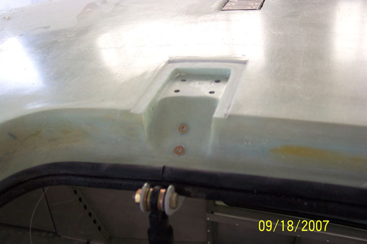

I looked long and hard at milling a set for my build and then considered producing them as OEM replacements. The “complex” angles made me think a second time about milling them not that it would be that difficult. (I think they penciled out to $100/pair) Eventually I came to the conclusion that there was no need as the hinge are going to stay in place even as the door is ripped off in flight. Maybe I should spend my time figuring out a way to reinforce the horizontal stab instead?
Ultimately we designed a cover plate I was going to leave polished till the painter shot it against my specific instructions.(It has to be the fumes!)
After all that angst I have yet to see another -10 that made me say to myself “gee I am really glad I made that mod.” I don’t even think I notice mine as the doors may block the view of the hinges when open. Or maybe I don’t see mine because they are painted. Regardless I think our solution is simple if you really want to go to the effort.
Robin
(painted photo attached)
http://www.painttheweb.com/rv-10/doors.htm
To install the hinge covers the scribes and routed out a channel for the hinge covers.
Below are two photos of the canopy top. One side has the hinge covers and the other side is the standard configuration. I will either paint the metal covers with the plane or I will powder coat the covers to match the smoke chrome of my steps and other items on the plane.

I recall that that I needed to flip the hinges, basically the high end goes on the back end of the front hinge and the forward end of the back hinge.
Don MacDonald makes the plates. They are very nice.

I made up about 40 sets of these.... because it was just as easy to make 40 as it was 4. I had them painted prior to installation... that way the hinges underneath were also totally painted. Don't have any pics of what they look like afterward.... maybe I'll shoot those tomorrow. If anybody wants a set of 4, let me know...send me an address... cost... $20 including shipping.... again not trying to make money here, just get some parts out there to my fellow 10 guys.

Here's the brackets after paint.

So what's the downside to glassing over the hinge on the top? Why would you need to remove the hinge from the top when you can remove the door? A thin cover glassed over the top side could be removed easily if/when it became necessary. Anyone done that???
As a side question: Any of the flying guys seen rust from the hinges??? What do you do to prevent it??

Assuming no better idea comes along C I think I will powdercoat for appearance and preservation.......then remove the coat from the moving surfaces.........and glass over the interior and extior hinge base.

These pics got me to thinking ..... actually a bad idea Razz WHY????
As a side question: Any of the flying guys seen rust from the hinges??? What do you do to prevent it?? Paint Them
Comments anyone???
Linn
