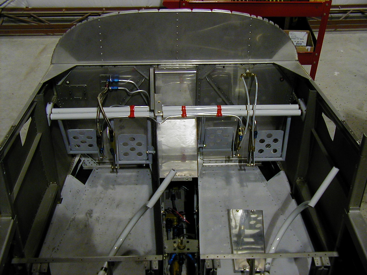

Charlie, this a test of a photo .... showing my re-routed brake lines as an insert to the email and as an attachment.  Hope it works. Linn
[img]cid:part1.08000307.02030405(at)bellsouth.net[/img]
