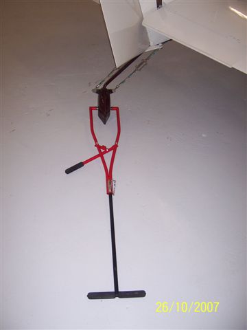

PostPosted: Mon Jan 04, 2010 11:34 am    Post subject: Tail wheel tow bar Reply with quote
itīs here and still an exellent value.
Raimo OH-XRT

PostPosted: Mon Jan 04, 2010 11:38 am    Post subject: Tail wheel tow bar Reply with quote
Mono is also pushable by BogiB.
That is practical when maneuvering.
