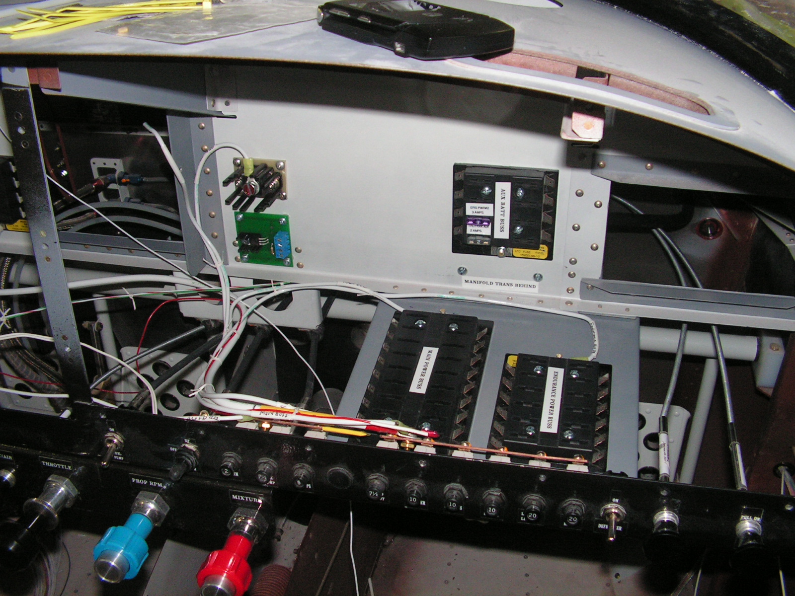

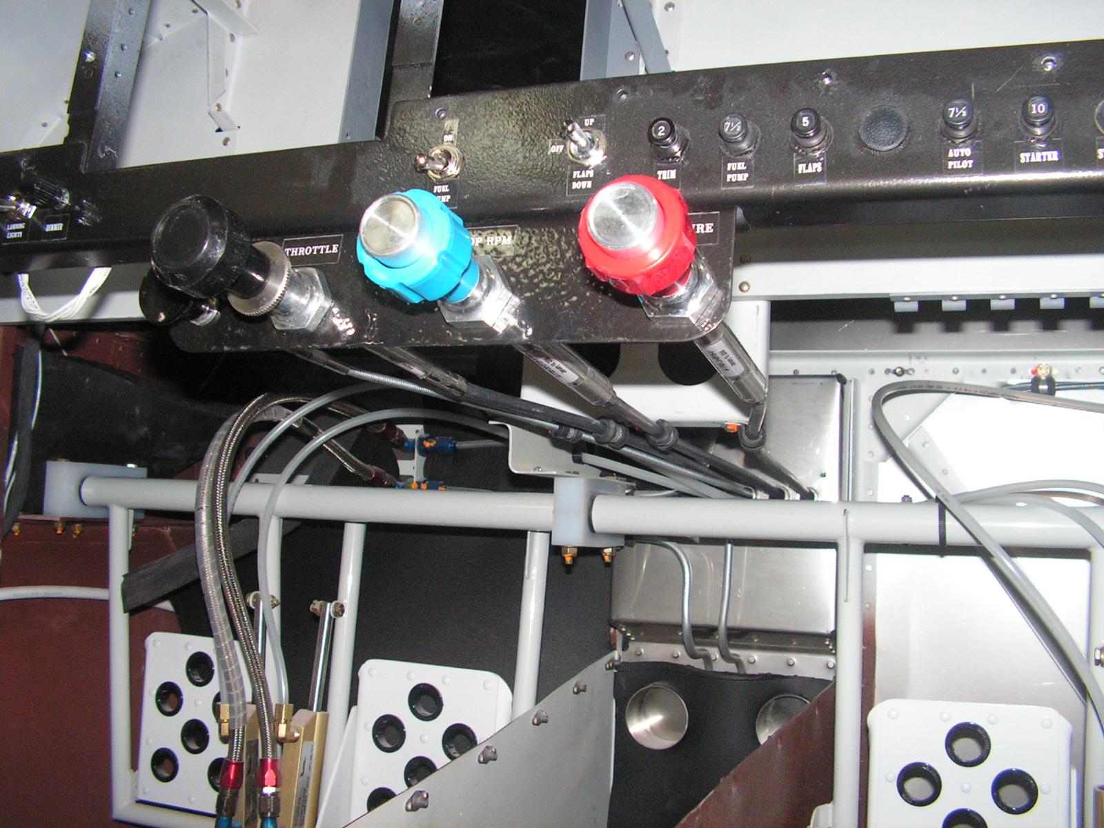

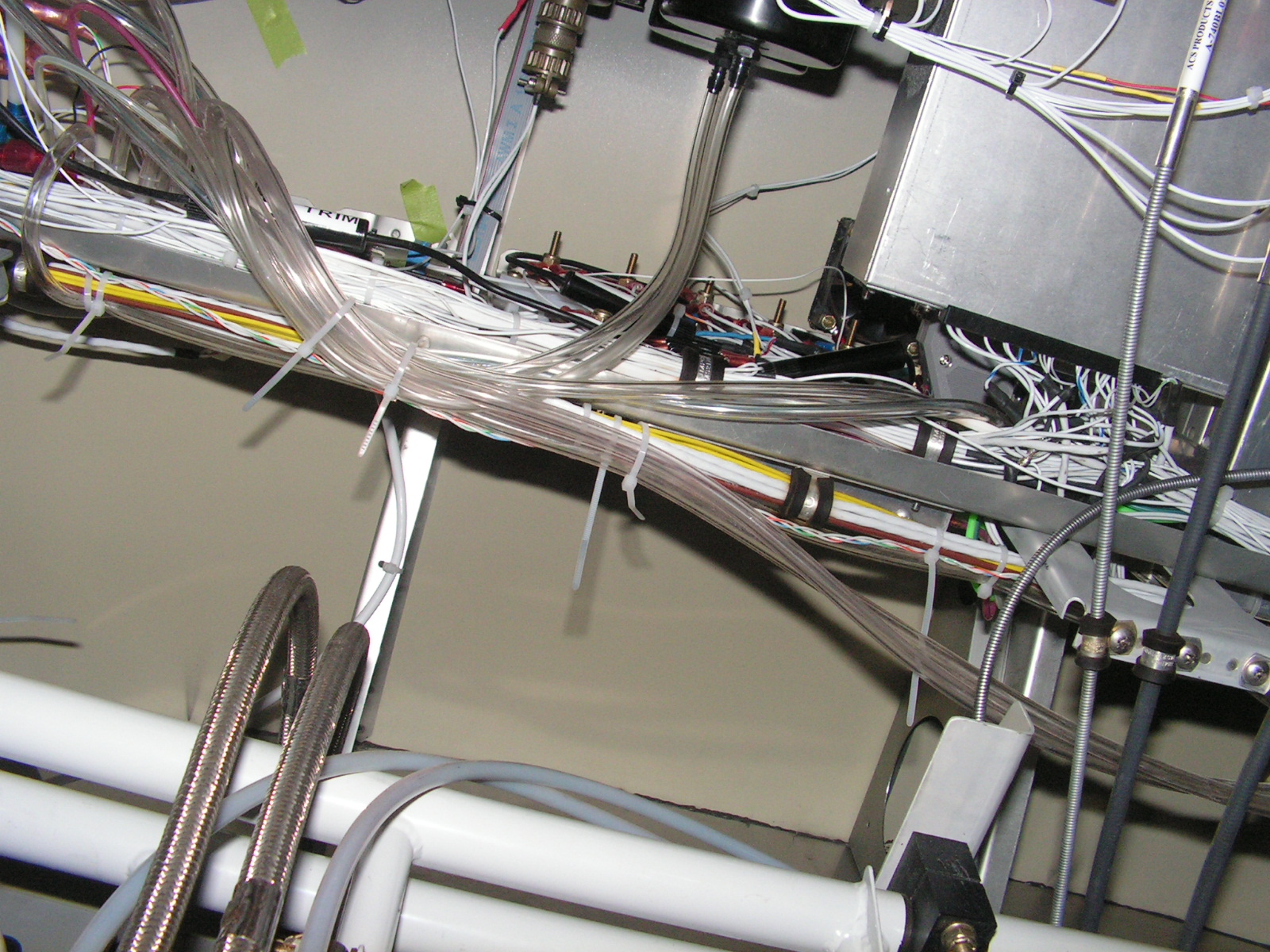

Does anyone have a close-up picture of the standard push-pull controls
mounted under the instrument panel???

Hi Linn C
The first picture is a partial shot of the Van's factory plane. The next two are of my RV-10.
Hope they help C

They do help a lot. I'm working on making the panel with all the breakers and switches removable along with my whole panel ..... all in one piece. I'll have to drop the bracket thag the engine controls mount to, and that was what I needed to look at. Finish kit will be on it's way early Jan .... and I didn't want to get myself in a bind.
