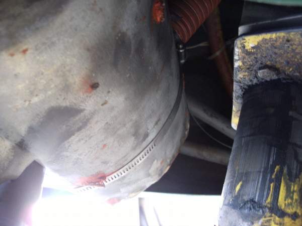

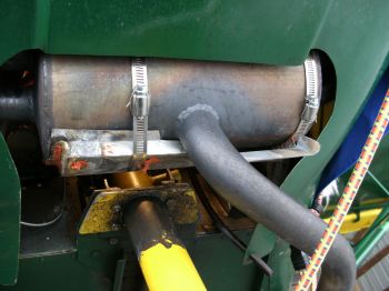

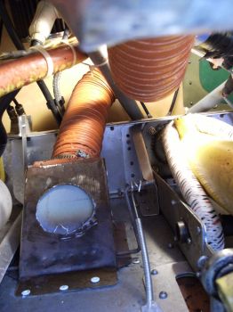

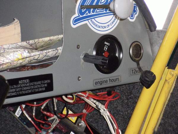

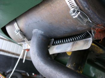

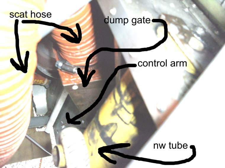

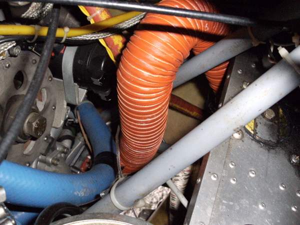

thought this is the best weather to post the new heater pics
one is of muff inlet with air flow modifier spring, another of muff backside, another of scat hose route from upper right side of muff over to gate,
another of a 30/ 60 angle dump gate mounted to firewall, another of the control cable on panel. toasty warm with oat at --10C.
