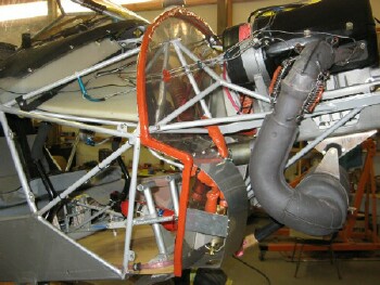

Mine is on the back side of the firewall, mounts with Adel clamps. I will get some pics of it when I get home next week. Some cowlings have an oil door in the them, but mine doesnt. I keep it outside and dont need another water leak in the cabin. I like being able to run long trips and not have to refill the oil. Last one I brought 6 extra Qts with me and did not use one of them till I got back home. I burned 70 gallons of fuel and used less than half the oil.
I think the tank was 90 bucks or something like that from KF.

Lennie, My tank is on the front of the firewall so any leaks would not enter the cabin. I mounted mine where a felow out in Maine that sold me the tank had his. He sent me pictures.

Guys, a properly adjusted 582 oil injection will only give 50 to 1 ratio at wide open throttle NOT all the time.
In cruise you might see 65 to 1 to 70 to 1 area.
At idle closer to 90 to 1 or 100 to 1 .
The oil injection ratio is dependant on throttle position.
Pictures of injection bottom mounting on Kitfox.
http://rotaxaircraft.com/forum/viewtopic.php?f=8&t=156

Kitfoxers, I have the oil reserve bottle pictured. If someone needs it, you can have it for $10 + shipping.

| akflyer wrote: | Mine is on the back side of the firewall, mounts with Adel clamps. I will get some pics of it when I get home next week. Some cowlings have an oil door in the them, but mine doesnt. I keep it outside and dont need another water leak in the cabin. I like being able to run long trips and not have to refill the oil. Last one I brought 6 extra Qts with me and did not use one of them till I got back home. I burned 70 gallons of fuel and used less than half the oil.
I think the tank was 90 bucks or something like that from KF. |
Thanks, I would like to see this setup. I have a panel tank so probably not enough room behind the fire wall, but plenty in front. Behind the fire wall would probably be better if there is room as my cg is nearer the forward limit.
I plan to fabricate an oil door for checking and adding oil.

Tom,
My oil bottle is on front side of firewall. I just put up a movie and when we take off you can see the access door for oil bottle.
Let me know if you need a better pic of it .
http://www.youtube.com/watch?v=dLKDyCSmo7s
| Tom Jones wrote: | | akflyer wrote: | Mine is on the back side of the firewall, mounts with Adel clamps. I will get some pics of it when I get home next week. Some cowlings have an oil door in the them, but mine doesnt. I keep it outside and dont need another water leak in the cabin. I like being able to run long trips and not have to refill the oil. Last one I brought 6 extra Qts with me and did not use one of them till I got back home. I burned 70 gallons of fuel and used less than half the oil.
I plan to fabricate an oil door for checking and adding oil. |
