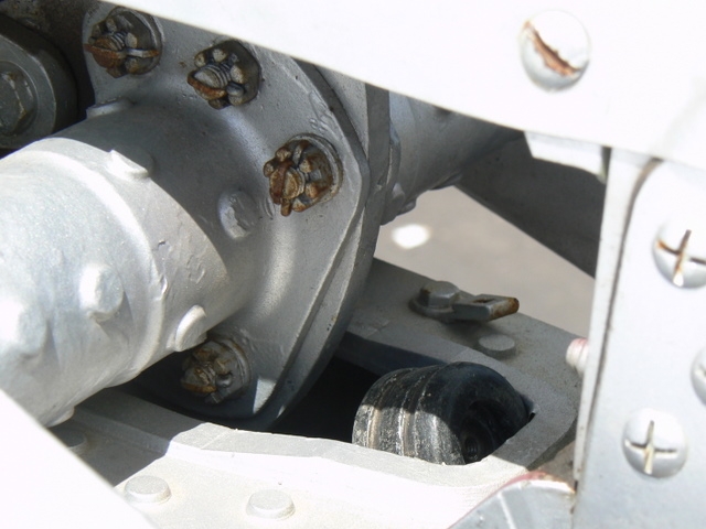

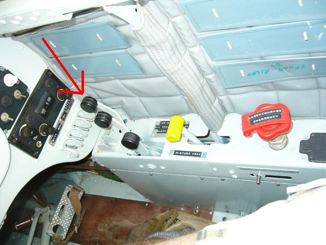

PostPosted: Mon Dec 14, 2009 10:07 pm    Post subject: Brit Saves YAK 52 with jammed elevator Reply with quote
Hi all
I'm not sure Bob is a Brit - as far as I know he is South African. The accident happened in Bisho, Eastern Cape, South Africa. Bob is one of the characters of local aviation, a very experienced aerobatic pilot and instructor.
One of the knobs on the gill control levers went walkabout several months back, and was replacd by the owner. Despite a search of the aircraft the missing one was not found - until now.
We're all pleased that the outcome was not a fatal accident - it was very close. It's been a very bad week for aviation here - airline over-run, a light aircraft over-run, and an Extra down on Sunday with two fatalities.

PostPosted: Tue Dec 15, 2009 5:23 am    Post subject: Brit Saves YAK 52 with jammed elevator Reply with quote
Mike,
Thank you for the correction and the update. As suspected errant FOD.
