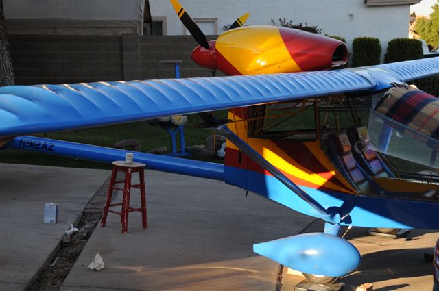

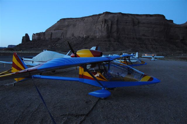

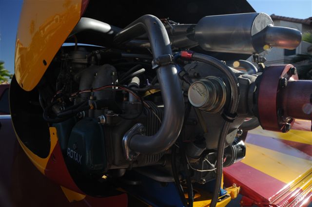

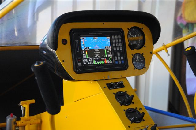

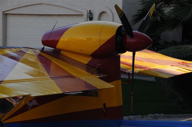

<<DSC_1983.JPG>> De <<DSC_2463.JPG>> nn <<DSC_2465.JPG>> is
<<DSC_2469.JPG>>
<<DSC_2471.JPG>> I have enjoyed Ricks pictures of the cowl project, it
certainly was fun for me. My hat is off to any one that dives into a
project and sees it through. Rick it looks great, The undisturbed air
really is a plus and the cowl becomes a lifting body. I had trouble here
in Arizona on 110 degree weather without the cowl ....if the tower had
me hold on the ground for long periods of time the engine would
overheat. On one occasion whale idling on the ground I overheated and
blew all the water out... now with the cowl I can idle all day long on
any Arizona summer day..I had to make a cowl flap for cold days (like we
are having today.. a balmy 50 degrees) to get operating
temperatures...... I have molds and would make a cowl if anyone was
interested.... it will not fit a VW engine it will only work on a rotax
912
Uncle craig

John my radiator has always been mounted in front of ther engine not
much air moving through it at idle...with the cowl air is moving at
idle. I feel the airfoil on our kolbs realy is not about speed. that
said the clean air going through the prop maks less drag. With the strut
farings and the cowl my cruse was 90 at 5300. I am yet to see what the
faring on the gear legs and wheel pants do. I have not had much time to
get it together since the pannel rebuild. I started it Saturday.. I have
an artificial horizion sensor problem..plan to get the bugs out it and
start it again tomorrow...hopefully fly B4 Christmas
