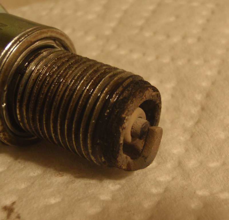

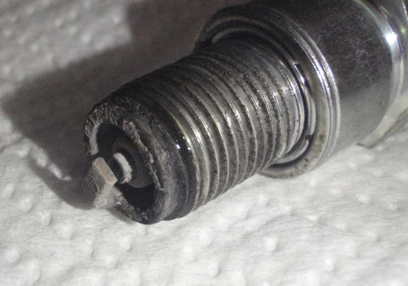

Somebody with a good working knowledge of the inside of a Bing 54 PLEASE HELP ME. Lets start at the beginning, as temps started to drop below about 55-60f I started having EGT trouble and I started reading up and doing some adjustments. The needle jet, jet needle, and up until yesterday the main jet were stock. I installed the HACman which comes with 180 main jets and I purchased but did not install the next size up of needle jets, 2.74 I think. I read that going up a needle jet size could cool off the mid RPMs but I wanted to work with the HACman before I made any more adjustments.
So today I had the HACman full rich for all but a couple minutes of the flight when I leaned it just to make sure it worked properly. Temp was 32f and PA was 500'. Climbing at 62-6500 yielded 1125-1150 and cruise at 5800 was 1175 as long as the prop was loaded, any decent and it headed for 1200. I went to adjust the needle and found that it was actually on the bottom ring, tho one that I am pretty sure is not supposed to be used for a setting so I actually took it back up to the third ring from the top just to see if it was a case of too far in the right direction is no better and nothing improved. According to the chart I have seen I should be running the 165 main jet with stock needles at all temperatures at this altitude but it is obviously not working.
Should I install the 2.74 needle jets? Might this fix the hi temps? I have a new prop on the way that is bigger and that should help a little but not when it is unloaded. What adjustments do needles make, is there a better needle for my situation? Where I am the temps often swing 25-30 degrees through the day and I cannot chase these EGTs.

PostPosted: Sun Dec 06, 2009 4:08 am    Post subject: Re: EGTs are killing me Reply with quote
JAmes
Stock jetting should work fine for you without the HAC MAN -
summer needle set at 3 rd from top
Winter (temps 50 F or less ) drop to 4th notch from top
If you are operating under 5000 ASL all the time you don;t have to worry much about leaning mixtures.
Your EGT gauge is calibrated (at) 70 F so if you are 20 F outside temp and the EGT gauge shows 1200 then that would be the same as operating at outside temp of 70 F with a EGT reading of 1150 F
EGT gauge are only a indicator of what is going on inside engine. Plugs will tell the real story.
You can also set your prop static rpm to 6000 and get a bit more load on it .

Oh, and the plugs are a nice tan color, I replaced them before the last flight. Although the fouling is undeniable. Stupid Avgas. I am switching plugs about every 10-15 hours just to be safe. Anyone have a guideline they use if running Avgas in a 582?
hey -- then you doing it right man.
Pistons start to melt 1300 to 1350 on the 582s 1200 is ok if guage is accurate. Plugs tell the rea lstroy and yours sound good.
I get 100 to 150 hours out of plugs- I only use Rotax NKG s Solid tipped yeah yeah yeah -- I know you can do this and they but facts says they din a better job. compare 6 $ a plug for 150 hour sto chaing your 2 $ plugs every 15 hours .
http://www.cfisher.com/ngk/
http://www.cfisher.com/ngk/ngk.htm
http://www.cfisher.com/ngk/tipsblack.htm
That is what thousands of hours of Rotax time will teach you .
Regular Gas is fine in 582 -- Avgas is not recomended but some use it without a problem.

PostPosted: Sun Dec 06, 2009 5:16 pm    Post subject: Re: EGTs are killing me Reply with quote
But you also use mogas and so you don't have the fouling problem. But at least now we are on the topic of e gas. How do you wash it? The only thing I have heard you can do is add water to it let it sit and then drain it off, this seems like a very time intensive process. And it requires you voluntarily add WATER to your FUEL. For the sake of argument though, how much water do you add to 5 gallons, and how long do you let it sit?
The other thing I understand about e gas is that ethanol is a solvent and will dissolve the resin used in older fiberglass tanks. I have a leaky tank so I plan on replacing them soon anyway with the ethanol compatible ones from McB. Once these are replaced is there anything else that needs to be done/replaced in order to just run e gas through the engine? i understand that ethanol has much less energy in it and so burns cooler and at less efficiency, I think I have heard that it usually has to run a little richer then normal, anyone know anything about that?

PostPosted: Sun Dec 06, 2009 8:06 pm    Post subject: Re: EGTs are killing me Reply with quote
E 10 is the standard here. Some places seem to "lose" their stickers advertising the ethanol but it all has it now. These are the plugs I pulled out Saturday morning. I don't have the exact number of hours on them but it is somewhere between 15 to 20. I had looked at those drop in wing tanks and now I can't remember why I was planning on buying from McB. So is there anything else in the fuel system that the ethanol messes with besides the tanks?
