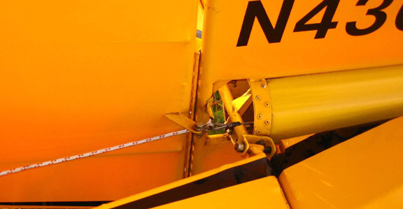

You are right it would nose over. Also don't trust wheel chalks. These planes are too light and can jump over. The best place is through the tail post (steel weld-ment in front of the rudder that attaches the 5" tube). So your rope goes on ether side of the rudder. Removing the wings makes the job easier.
Good luck,
Dave
 Filesize:  35.75 KB
 Viewed:  10391 Time(s)
