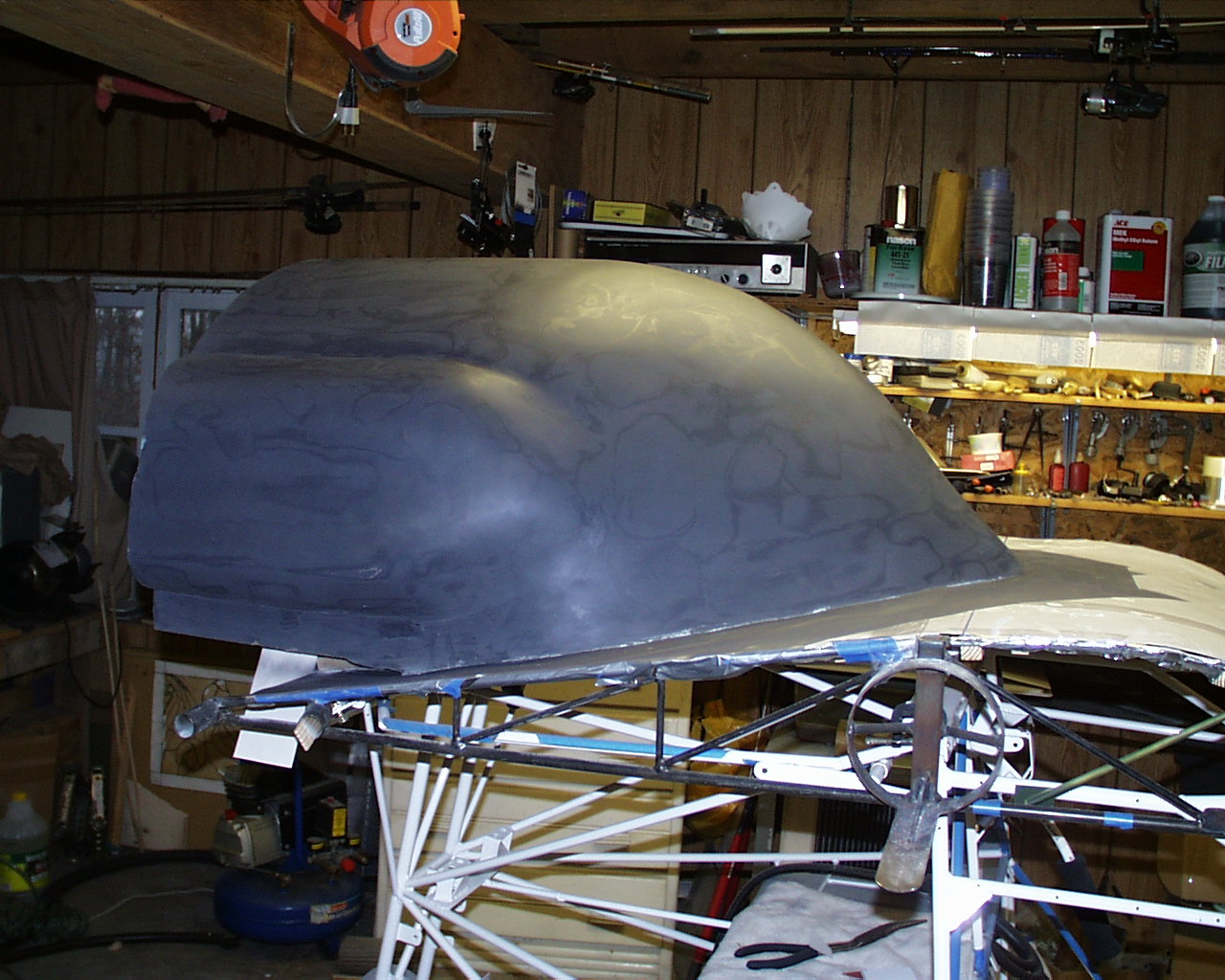

I need help from someone in the know about what I should use for mold release. I have attached a picture of the cowling I'm building and want to be sure the fiberglass layup will release from the plug in picture. I have tried, on a test piece, some mold release agent but it doesn't seem to work. I have laid up another practice piece, this time using some car wax on the part. Will see how it does tomarrow morning.
The cowling plug shown is carved foam covered with bondo to give it a hard shell. The final covering is two coats of sandable primer. I sure want to make sure the fiberglass with pop loose from the mold after cure.

They call it mold release wax as I recall..Boat builders,,,Aircraft
spruce etc... It may be that the heat of curing will overcome some
other types of waxes..?

  Once you've got your plug finished C the first coating should be PVA mold release.  Next C you'll want to apply a few layers of carnuba wax C or even better C mold release wax purchased for exactly that purpose (which is carnuba wax).
  Between the layers of wax C let them dry properly C then buff them out shiny C just like it was your car.  After you've got about three layers of a good wax base C apply your gelcoat.

What I have tested with so far is PVA mold release. The directions say to spray it on in several layers but since my test part is small I just brushed it on, two layers. Maybe I should try it again by spraying on as directed is several layers. I would seem if you had enough layers of this mold release on that the fiberglass would easily come off. I will look at Aircraft Spruce and see what they have.

  The PVA's primary mission is to protect the mother mold from being affected by your layup.  The wax is to allow for easy part removal.
  The PVA is very water soluble.  Once you've removed the finished part C you wash the mother mold with water C in order to get back to the pristine surface.
  PVA is NOT meant to act as a part release.  Wax is.

Thanks Mike, that makes sense. I have three gallons of PVA release agent. That should be enough to last me a lifetime. I just ordered the release wax from Aircraft Spruce. I will do another test on all this when I receive the wax.

   Check out Fiberglass Coatings Inc.  www.fgci.com  They have a how to section on their web site.  They supply a lot of the boat builders in the Tampa Bay area.
I have used their procedures and products on a Velocity project with good results. Just be sure your plug is shiny-smooth and sealed before you start on mold and you should do OK.
