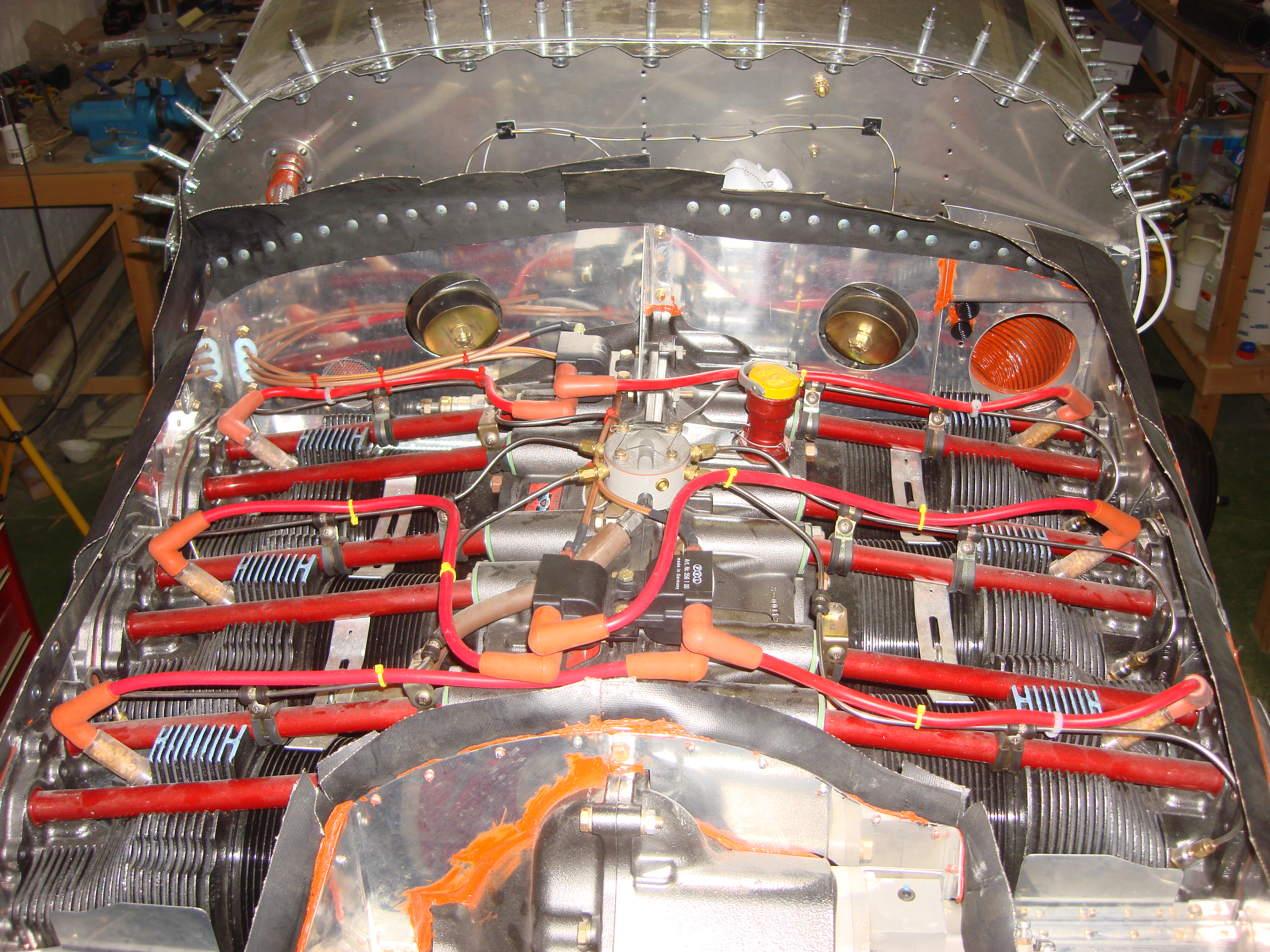

I just wanted some feedback if the cable routing is ok and if using cable-ties is ok. If not what did others use.
Thanks Michael

Don't use the ties around your fuel injector lines or oil return lines underneath the cylinders or around your engine mount. Use adel clamps on the injector lines like you already have from the engine shop.

In addition to the below comment, one thing I got from one of my inspectors
a few airplanes ago was not to tie things together directly with the tie
wraps as it invites chafing. Instead use 3 tie wraps, one around each item
and then one to connect the two tie wraps. I vaguely remember some
discussion contrary to this, but that was from an FAA guy and it made sense
to me.
The routing itself looks very nice in my opinion.

A couple points:
First, as unlikely as it seems, cable ties will chafe into aluminum and steel tubes after a couple hundred hours or less.  Adel clamps are a huge pain in the butt but there's nothing better for securing something to a tube.
Second, I've never had any luck getting the adhesive pads on cable tie mounts to stick very well, even under the best conditions.  Don't count on those on the firewall staying there very long.  In cool areas we glue them on with Hysol.  In a hot area like the engine compartment you're gonna need a pop rivet or two.

You can also use silicone tape which sticks only to itself. Then a cable tie over the tape. Just not too tight on the tie over the tape.

I am with Dave - I used a roll of silicone tape from Spruce to tie it all together. It is awesome. Use a scissors to cut the 1" strips into 1/2" strips and wrap it around anything loose. EGT. CHT wires, ignition, all the ignition wires and EFIS wires, and as an anti chafe. I think that it goes to 400 degrees Fahrenheit. Even if the cable ties do not melt on you they harden and break over time. Only behind the firewall.

Thank you for all your great feedback. I'll see if I can use Adel clamps.

Google 'rescue tape' ..... I bought their sampler kit with 6 or 7 colors.

I like the silicone tape also. I shopped around and settled on F4 tape at Amazon:
http://www.amazon.com/F4-Tape-Self-fusing-Silicone-Oxide/dp/B001HETINI/ref=sr_1_1?ie=UTF8&s=hi&qid=1260108700&sr=8-1
The blurb says "avation", it got an excellent review, and I got two rolls to qualify for free shipping. It is very easy to cut, as you say, and very simple to add more wires to the bundle later by adding another strip.

Check this for under the cowl

Never use cable ties in the engine compartment to secure anything to a motor
mount, any fluid line, always use clamps. Cable ties will eventually either
stretch or just come loose and will chafe and worse will get dirt and grime
under them then chafe with dirt under them (sand paper) and will wear holes
in everything.
Clamps will hold a lot better and not wear out like cable ties do.

I thought that AC 43.13-1A made it a no-no to tie electrical lines to fuel lines. Why is it OK to tie a spark plug line (which are known to arc over) to a fuel injection line? I didn't see anyone mention this. Am I in error?
