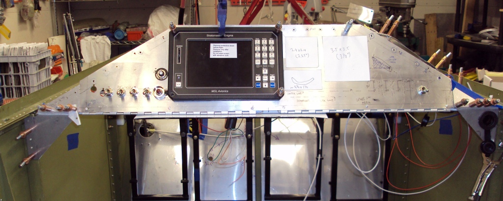

I've done a fair amount of crimping and a little soldering while wiring my instrument panel mockup, and have a few questions. Maybe posting one or two pics per post will work. This is for my Jabiru 3300 Sonex with a standard ~30 degree tilted panel. I've put a piano hinge along the bottom and top with a few nutplates to go on the side. The tank and glareshield are removed. Tank has roughly the same cross section as the panel face, starts about a foot in front of the panel to the firewall.

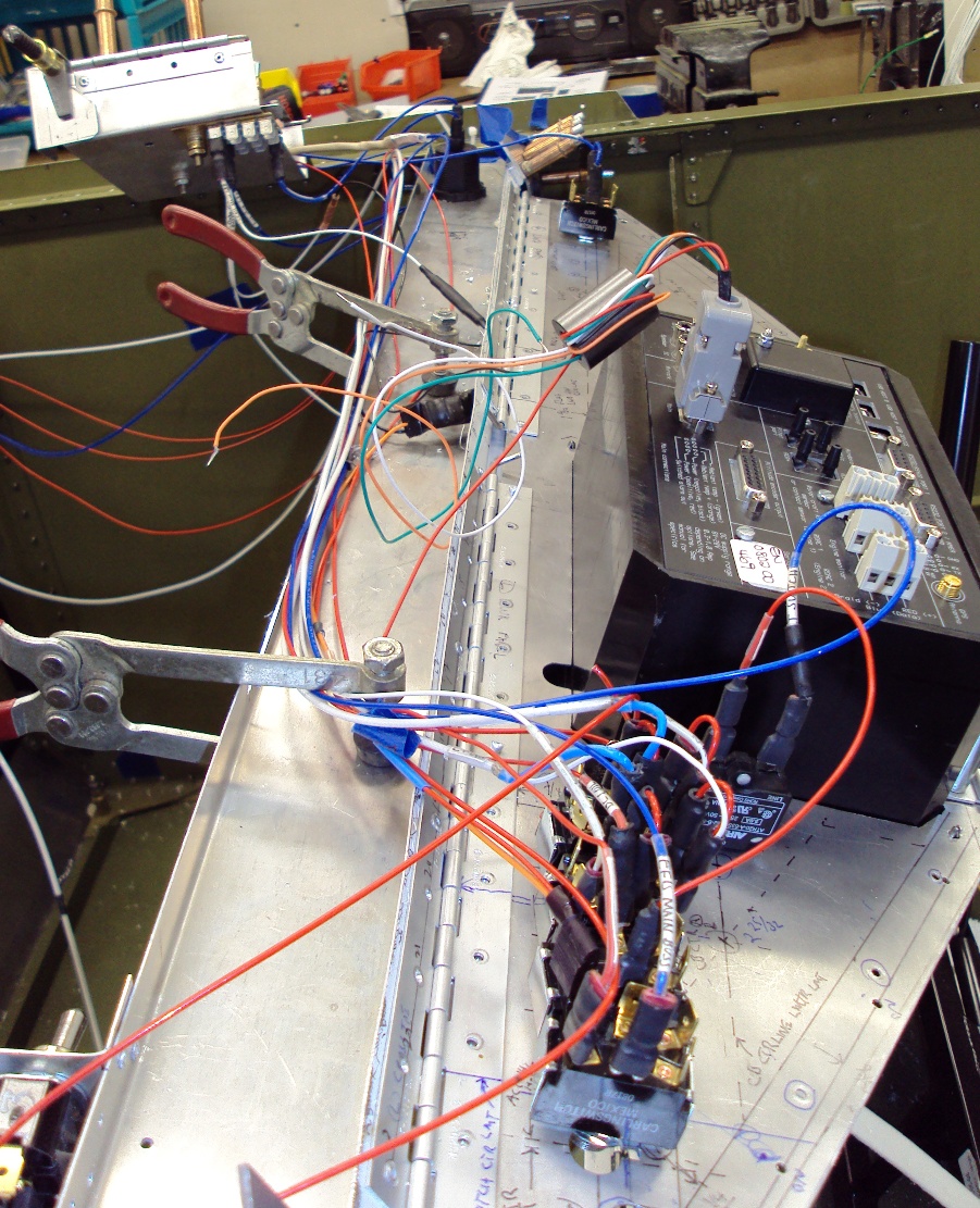

This pic is from the left side looking right, with the panel tilted forward. Some have had interference problems with the top of the Enigma hitting the glare shield, but mine just fits.
At the top of the pic you can see the cover for the main buss. It's mocked up to fit on the underside of the glare shield. Taking out the top hinge pin will let it swing down for easier access. On the bottom side of the cover I've mounted a section of ground tabs.

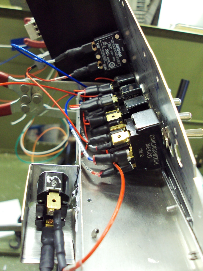

This is with the panel in the closed position. The channel that the lower piano hinge attaches to is 025 with either 1/2" or 3/4" flanges. Some of the longer wires, like the blue one in the foreground, can be tucked away from the flange. There are a few shorter wires that need to have a zip tie pull them up and away, or maybe ben up the switch terminals. The 3rd switch back is a good example. It has a white and red wire resting on the flange.
In the foreground is my security switch for the starter button, mentioned in earlier posts.

Since a DPDT switch is the same size and almost the same price as a SPST, I thought I could increase switch reliability by putting in 2-3 instead of 1-3 switches. The pic shows one for a magneto lead. I separated the shield and put blue heatshrink on the braid and covered the junction with a piece of clear heatshrink.

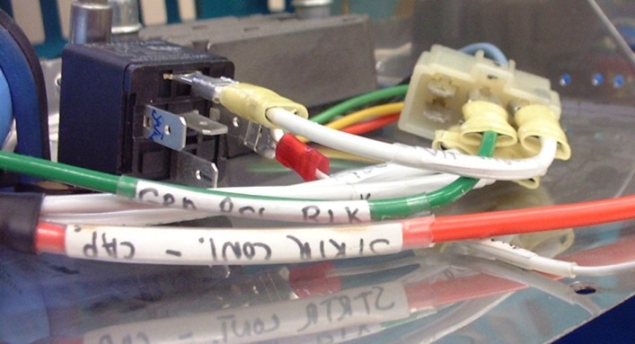

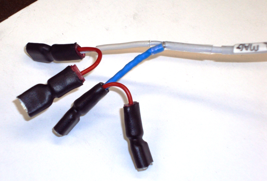

Last week I crimped connections betwen my regulator and alternator relay. The Jabiru regulator comes with a harness or whatever you call the plastic thing with 6 male faston blades inside. Besides being a bit cramped in there, one of the blades is a bit loose. I think it just got pushed or pulled out of its socket, since I can't budge the female-male faston connection. For this reason I'm thinking of cutting off the plastic harness (and tabs, if needed) to free up the individual wires.
I also realize the fastons to the relay aren't in all the way. And it needs a diode.

I do have one suggestion about the regulator_fastons_118.jpg. Unless it will be necessary to periodically disconnect the cable going to the regulator, you could eliminate that plastic connector and the fastons. One of the regulator wires could go directly to the relay. The other wires could be butt spliced like this:
Code:
http://www.aeroelectric.com/articles/PM_Solder_Sleeve/PM_Solder_Sleeve.html
Joe

It looks like you are putting black heatshrink tubing on top of the insulated faston terminals. Is that for additional strain relief?

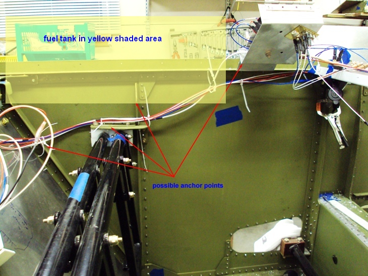

Another issue is what route to take and how to fasten the wire bundle going from the firewall to the channel behind the instrument panel. Many have used the zip tie bases and simply glued them on. But I would like to see if I could do without glue that might let loose sometime in the future, especially in such a hard to reach place.
From my firewall bulkhead fitting to the side panel is about 12". This fitting is just out of view on the left of the pic. I would use the same zip tie anchors but fasten them with SS rivets through the firewall. 2 or 3 should do with zip ties also spaced between the anchors.
Then, instead of the side panel, I could use the 1/8" angle to support the anchors or clamps shown in the first 3 arrows in the pic. There would only be 3 or 4 inches between the anchors. After the upright angle I could go 8" to the bottom of the cover for the buss box, or follow the fat wire through the box itself, since there'd be room . The buss box cover will be fastened to the underside of the glare shield 2 or 3 inches behind the tank. Then the bundle would go another 4" and drop into the instrument panel tray.
I had shied away from using the upper longeron as support, but now I think that may be a better route. Instead of going to the buss box, I could simply rivet angle clips every 3 or 4 inches along the longeron to the panel tray. I could use either zip tie bases riveted to these clips, or use Adel clamps.
How does this sound?
The AMP PIDG terminals I got have the non-terminal end insulated only. Then when I first started crimping, it looked like some of the plastic could have been poked through. To be safe, I figured I'd best put on heatshrink, which could also be extended to cover the whole terminal. In some areas it also helps as a strain relief. Other areas I actually had to cutoff some of the heatshrink because this prevented it from bending as tight as I needed, like behind the switches. And putting on the heatshrink is pretty fast and fun, too!
Dan

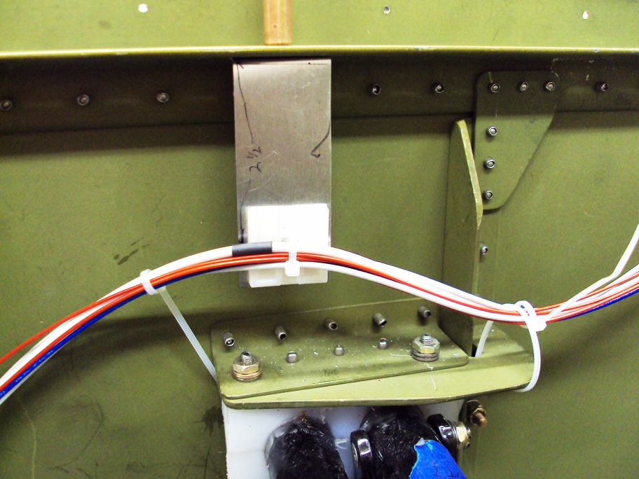

wire ties should not be used to support wires
Seems to me a zip tie fastened to a tie base could fail where the base attaches to the structure, the two little plastic rods of the base where the tie slips under, or the zip tie itself. I think doing what I did in the pic below remedies the base to structure problem. I just bent a piece of 025 and riveted through the hole in the middle of the base. That's not gonna come off. In this particular shot, I made the angle clip 2.5" to the rivet. I could shorten that to 1", but 2.5" gives it more room between the clip and tank, since the sides of the tank angle down and toward the center. So if I had to service this item, it wouldn't be too hard...as long as I could still do a Fosbury Flop under the tank!
So the question is, could the zip tie or little base rod break? If so, I'd opt for the metal clamp. I suppose I'd still want the angle clip to give me clearance. Just replace the plastic base and tie with an Adel clamp.... and pray I don't ever have to mess with the dang screws later!

PostPosted: Sat Nov 21, 2009 10:54 am    Post subject: Dan's Switches Reply with quote
At 10:31 AM 11/21/2009, you wrote:
Good points, Bob and Joe.
There ARE bond-studs that can be used to attach non-structural
components to the airframe without drilling holes.
See:
http://www.aeroelectric.com/articles/Bond_Studs.pdf
There are aerospace grade, fast-setting bond studs
too . . . but you don't even want to know what they
cost.
Tie-straps and their companion stick-on/screw-on
bases are problematic. Likelihood of finding stuff
in your local hardware store suited to your task
is low.
Adel (or MS21919DG series) clamps are almost NEVER a poor
choice. All metallic fastening is also almost NEVER a poor
choice. Any process involving plastics or stick-ums can
be a good choice but stick with proven recipes for success
for both ingredients and process.
???? how was the plastic on the PIDG terminal being
compromised???
You may have a crimper vs. terminal compatibility
issue. The tool should NOT damage the terminal.
compromised???
The metal insulation closure when pinched down poked through the outer preinsulation. I thought I was getting a decent device when I bought the Crimpmaster. I found that terminals don't fit well in it, both in the direction of the wire and in the direction of the handle. I tried a few different adjustments and gave up. I have done almost all of my crimping with a GB cheapo I have and pull tested enough to know when it's good.

PostPosted: Sun Nov 22, 2009 8:27 am    Post subject: Dan's Switches Reply with quote
At 03:41 PM 11/21/2009, you wrote:
<jmtipton(at)btopenworld.com>
Hi Guys
What's the chosen method of shrinking, 'heat-shrink' ?
Heat . . .
Seriously, it depends on your situation. I've had $150 heat
guns than put concentrated heat into tiny spaces. They're
quite useful when working inside some piece of electronics.
95% of the time, a $15 heat gun from Harbor Freight does the
job. ANY heatgun can supply MORE heat than you need. Get
used to the specific combination of shrink, situation and
tools before you dive into finished work.

PostPosted: Mon Nov 23, 2009 1:38 pm    Post subject: Dan's Switches Reply with quote
> compromised???
Are you sure you have the right die-set
for the Crimpmaster? As I recall, there's
a suite of interchangeable dies offered
for that tool. I'd be interested in seeing
what you have. I'll pay the postage back
if you pay the postage to me. Send me some
of the terminals you're using too.
Thanks for the link to the article, Bob. In it, however, there are a
couple jpg links that were broken.
Yeah, I saw that but didn't have time to fix it then.
I've got a major overhaul of the website in the works
and hope to get the majority of bugs squashed then . . .
And the pic in the article of the bond stud shows what looks like a
nylon P clamp. They're okay to use?
That figure illustrates the idea and implementation of
po-man's bond studs. Except for specifics pertaining to
the procurement and installation of studs, anything else
you see needs to be filtered through the cookbook for
recipes for success. The parts shown here:
http://aeroelectric.com/Pictures/Wiring_Technique/Lightening_Hole_Wiring.jpg
are another illustration of technique and not a recommendation
for parts/materials.
