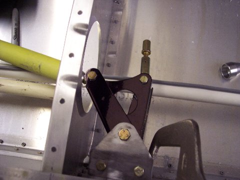

Well I got my new parts today and the new push/pull tube is gonna work out just like I thought.
I won't have the wing finished until the end of the week and the new .035 tubes won't be here until the 9th.
I will add a .125 plate to the spar and rivet the new angle brackets to them. I will also add a access hole to the underside of the wing to service the new bell crank.
Here is a pic.
