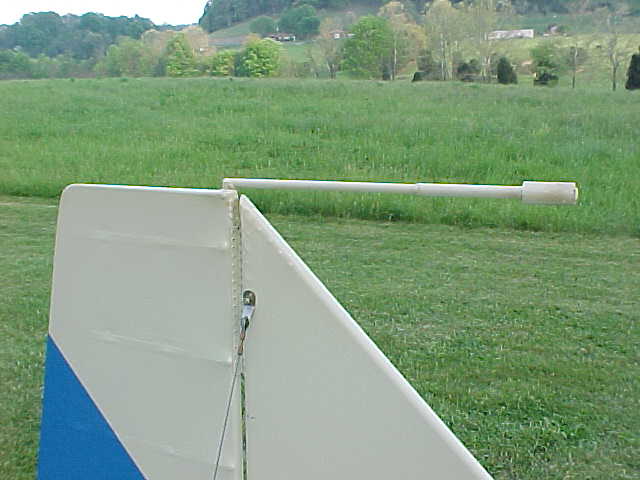

PostPosted: Wed Dec 02, 2009 9:45 am    Post subject: Re: There I was on downwind Reply with quote
Here is the counterbalance I made to stop the flutter. Ugly as sin, but works. Since I didn't want to take the tail off and turn it sideways to see what it would take to balance it, I just kept adding weight to the front until it would fly feet off and behave.
You just have to decide which is easier - crawling up into the nosebowl (John is obviously more streamlined than I am) and fighting with stronger springs (and not snagging/sticking them into your fingers) or sticking a bird perch into the top of the rudder. Ya pays yer money and takes yer cherce.
Here's the link to tubing sizes, etc.
http://www.bcchapel.org/pages/0003/pg6.htm

PostPosted: Wed Dec 02, 2009 10:20 am    Post subject: There I was on downwind Reply with quote
cherce.
Richard Pike

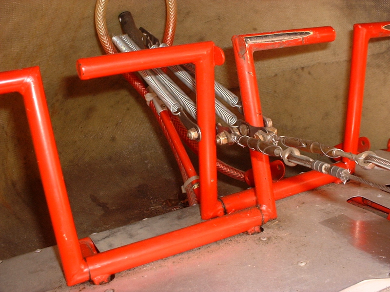

Rev/Gang:
I didn't have a problem installing double springs on the rudder pedals.
Took a few minutes to fabricate a few suitable tangs to hook and seperate.
No hint of rudder flutter since I doubled up. Seriously, a very easy job.
If I remember correctly, the rudder pedals on my mark three are pretty easy
to reach without becoming a spelunker.
I prefer my double springs, quick, simple, and work, over attaching a big
weather vane on the rudder. A much cleaner installation from my point of
view.
Plus, I already had the springs on the shelf. Wink

PostPosted: Wed Dec 02, 2009 8:48 pm    Post subject: Re: There I was on downwind Reply with quote
John Hauck wrote:
Rev/Gang:
view.
mkIII - Repairing dings in my new Warp Drive blades after a couple
unidentified flying objects made contact with all three blades.
Here's the picture again. John, bet your Miss P'fer is happy to be in the air again!
 Filesize:  267.01 KB
 Viewed:  15589 Time(s)
Cristal Waters
Private Pilot Aug 2008

PostPosted: Thu Dec 03, 2009 5:50 am    Post subject: There I was on downwind Reply with quote
the air again!
Cristal Waters
Thanks, Cristal:
I had forgotten exactly what my rudder springs looked like.

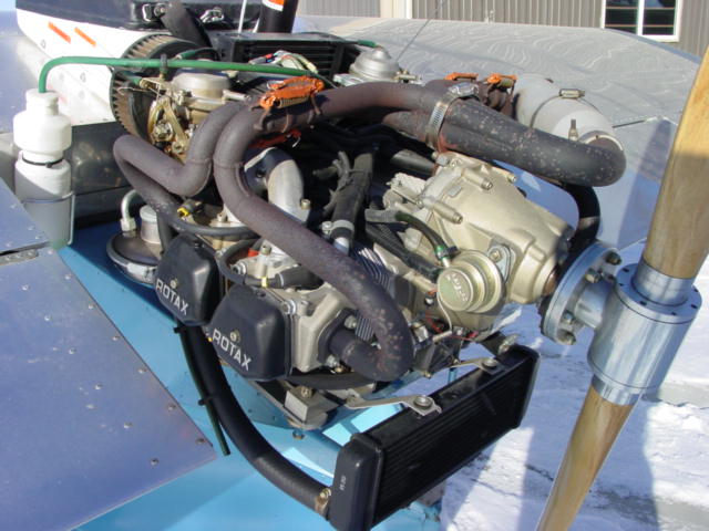

PostPosted: Thu Dec 03, 2009 6:15 am    Post subject: Re: There I was on downwind Reply with quote
John H,
I don't know what kind of exhaust/muffler system you had before the Titan but the Titan exhaust (unless they've changed it in recent years) is notoriously loud. When I was flying a Titan my 912 had a custom built exhaust 4 into 1 like the Titan but with a real glass-pack muffler about 3 1/2" diameter and maybe 12" long and it was the quietest Titan 912 around. I hope your Titan muffler is better than what they used to use. Attached is a photo.
912 with good muffler system
 Filesize:  60.48 KB
 Viewed:  15567 Time(s)

> I'm not arguing against bungees if they hold the pedals firmly. Firmly
holding the pedals is the goal, regardless of the method. Just describing
what I use, as are you.
Thom Riddle
Thom R/Gang:
As I was fixing my third cup of coffee I realized I haven't had to use a
bungee on the rudder pedals since I went to double rudder pedal springs.
That's what happens when one doesn't fly enough to be familiar with their
airplane.
by0ung(at)brigham.net
PostPosted: Thu Dec 03, 2009 10:31 am    Post subject: There I was on downwind Reply with quote
Thom R/Gang:
If my rudder pedals don't move, that is stiff enough for me.
I can assure you all, that a couple wraps of the pedals with a bungee cord,
or a piece of rope, will get the job done. Not necessary to carrry steel
straps in the aircraft. Bungee or rope is much easier to handle.
I borrowed an idea from our old friend Arizona Dave. When parked I have a
short piece of parachute cord that has a loop at both ends. One end goes
over one rudder peddle, loops around the other, then routed around the tube
in front where the rudder springs attach, then back to the control stick.
There are 2 more short pieces of parachute cord one goes to each side of the
fuselage cage at the sides of the back rest, when they are all tightened up
it keeps the rudder and the control stick all locked in place.
Boyd Young

PostPosted: Fri Dec 04, 2009 11:06 am    Post subject: There I was on downwind Reply with quote
John,
I also doubled up the springs,all four the same,still have a little wiggle.Thought about heavier springs but then got to thinking about the rudder horns structural limits and figured I better not.Going to revisit the issue when back home from Fla in the spring.Thought at first the Jabiru was the problem.
G.Aman MK-3C 200 Jabiru
Universal fit parts, don't.
PostPosted: Fri Dec 04, 2009 2:06 pm    Post subject: There I was on downwind Reply with quote
Gary A/Gang:
Could be loose tail wires, fabric tension, a quirk that can not be identified, etc.
If you can stop the shuttle with your feet on the pedals, maybe you need heavier springs. My springs are pretty stiff.
[quote] I also doubled up the springs,all four the same,still have a little wiggle.Thought about heavier springs but then got to thinking about the rudder horns structural limits and figured I better not.Going to revisit the issue when back home from Fla in the spring.Thought at first the Jabiru was the problem.
