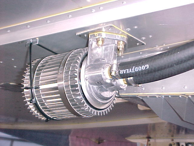

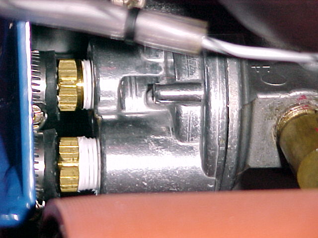

larry(at)macsmachine.com
PostPosted: Mon Nov 30, 2009 6:50 am    Post subject: Oil cooler on EA-81? Reply with quote
Greg,
A friend, Kelly Meiste placed his oil cooler adapter where the filter
goes and then extended his lines to make the
now large filter a finned adaptation that works rather well. You could
place the conventional cooler on one side of the
lines and hide the filter elsewhere. See attached images.

PostPosted: Mon Nov 30, 2009 8:24 am    Post subject: Oil cooler on EA-81? Reply with quote
I mounted a racing Oil Cooler on the right front just behind the cowling on
my 601HD. Our oil temps are in the 180- 90's We set up an adapter to the
original filter mount and ran lines to a remote filter assembly mounted on
the firewall. This works very well and doesn't add that much weight.
Leroy Wheeler
